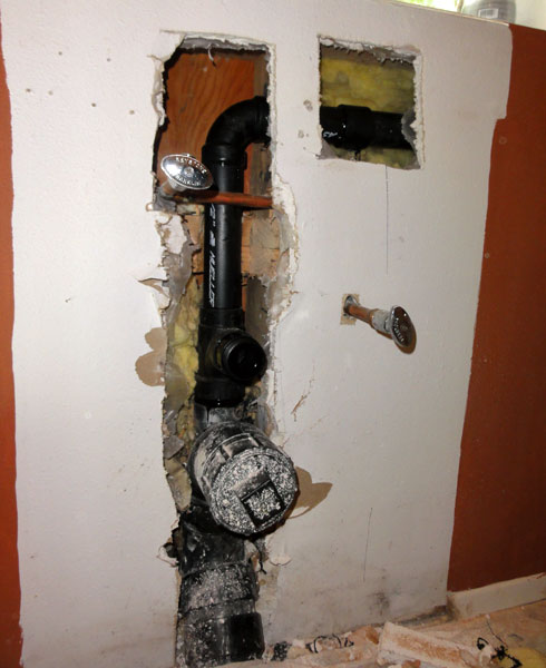

iGas
Feb 7, 2009
6,240
11335d1219264647-installing-new-faucet-kitchen-wit-garbage-disposal-dishwasher-air-gap-installation.gif
Take the P-trap off and put a bucket underneath the open pipe and turn on the water to see if it drain into the bucket.
There maybe a clog between the disposal and P-trap.
The other possible clog could be at the marvel connector.
Or, just admit it that you are not handy enough for such a job, and hand in your man card, and call a plumber.
