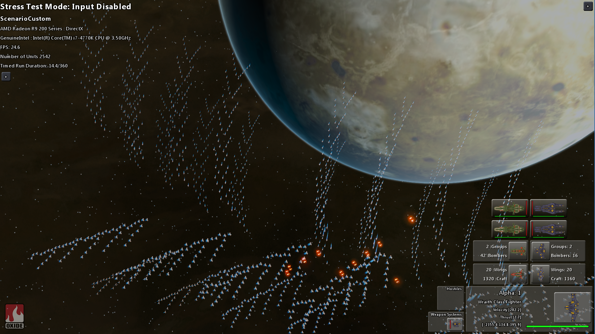

After watching the video again, the graphics look different, the 980 looks to me missing certain things compared to the 290x. On the 980 the ships go from having a blue trail to having none, to having blueish glow again. Also when there are explosions at first you will see things coming away leaving a red trail, I don't see that on the 980. There are also ships that shoot out bright red things that are grains of rice shaped. On the 980 there is no color to them at all and you can barely tell the ships are firing.

As I mentioned above, the 980 looks to be not be rendering certain parts which could very well cause it to have better performance. Plus this is not a real benchmark as in it's not the same every run and doesn't go a fixed length. So it really doesn't tell you much other than the CPU overhead is greatly reduced.

Look at 15, 22, and 56 on the 290x DX12
Then look at 10, 14, 37 on the 980 DX12
First one look the middle top left you will see red streaks behind bright glowing pieces to the left of the explosions on the 290x.
Second looks at the ships that just spawned at the middle bottom, you will see blueish jets coming out the back, on the 980 just the ships.
Last you will see bright red shots coming from the ship on the bottom on the 290, and barely see anything from the shots leaving the same ship on the 980.

Damn, you're right. Nice spot.
Definitely they render the scene differently. o_O

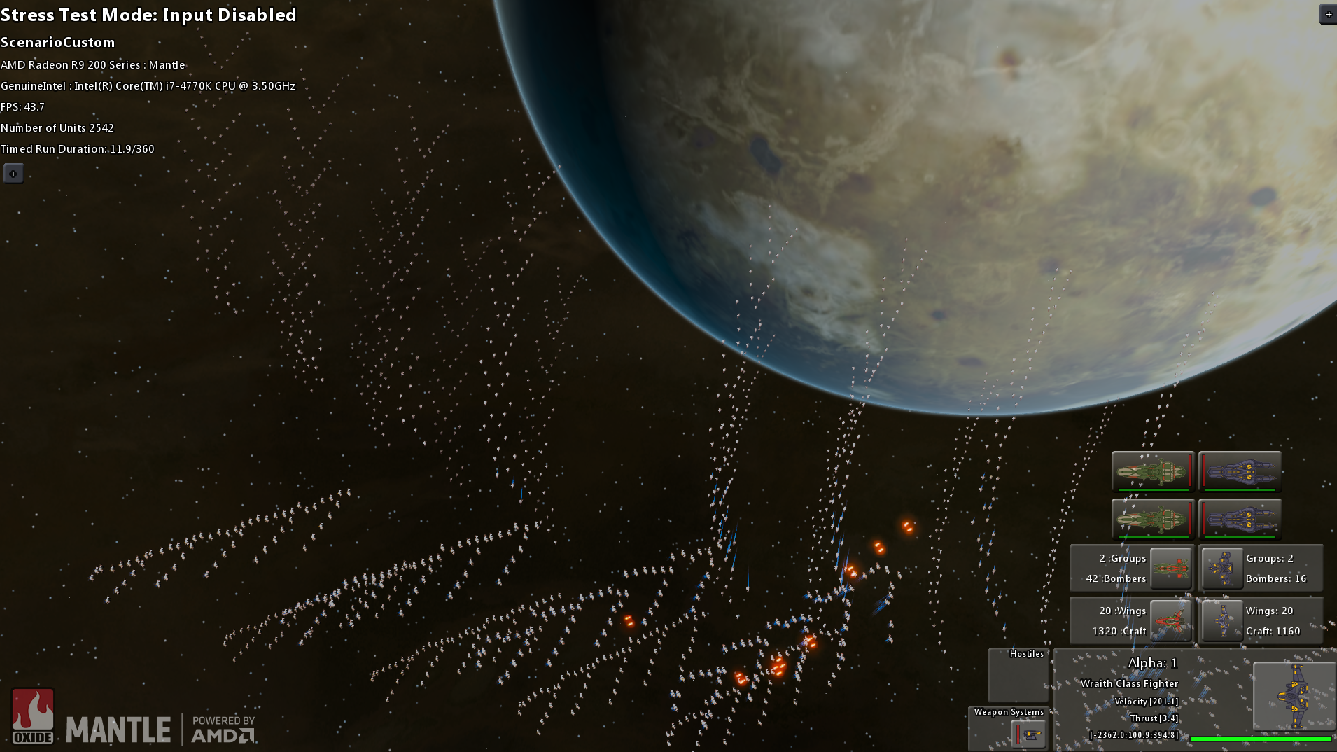

Well if its not rendering some special effects, explosion sprites, ship trails... must be beta drivers on beta windows. :/
Each run is a little different, but it is actually not rendering things that it should be, as the objects are there in all just the 980 isn't rendering them in DX12. That said I am sure that will be fixed with drivers, just it will also lower performance.
Thus as I said you can't draw any real comparison here except that DX12 is similar to mantle in performance, and has much lower overhead.
Or the reverse is true, the R290X is rendering extra things it shouldn't be. :/
I've reproduced the situation on mantle before. Last year actually.
280X DX11 vs. mantle
(open in a new tab)
I have no idea why it happened but I was never able to see any performance differences due to the trails (or whatever the blue things are) being less noticeable.
Either way the real performance killer in star swarm is motion blur, nothing else will give you extremely big performance differences. Motion blur will drop your perf in half.
