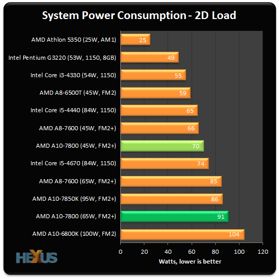

38 vs 31 W at idle for the A10-7800. Just shows how much impact the motherboard and the rest of the test setup has on the idle power consumption. :eek:
Even hexus doesnt compare apples to Apples on the FM2+ platform. Look in their test setup. Different board, different drivers
The lazyness of review sites is astonishing.

Those Hexus power consumption numbers seem odd. The 7850K is turning in lower power consumption at 2D load and 3D load than the 65W 7800.
Could this be the 7850K doing the infamous "throttle to 3 ghz" routine while the 7800 is not?

Could be more than that though. I mean you can see how incredibly close the two come performance wise on the Anand tech benchmarks. Identical for some tests and never really more than a very small lead overall.
Frankly if its a 'real' 65w vs 95w you'd want to know what they've done with extra 30w of power budget :) Maybe it is just that the overall design is much happier at a 45/65w power draw. Maybe bandwidth issues throttling things, maybe its turbos everywhere, goodness knows.
Quoted power draw never the most meaningful thing in the world of course :)

A 34 watt increase at the wall vs a 54W TDP i3. Shocking. All that extra power for less performance. I really want to see the data showing a G3258 + discrete outperforming kaveri in Perf/watt. I am confident it will but have yet to see the data.
