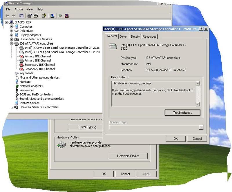

I checked, but the HD is connected to SATA running under IDE. But I could run it as AHCI which is new to me. The DVD-Burner is also SATA. THe board has 6 SATA connections, SO I possible could have put them on the wrong port. I believe HD is on port 1 and DVD port 2. So in device manager, I have disabled all IDE controllers, and left the 2 SATA that pop up inside IDE.
I just don't get it. Here is a pic.
<a href="http://s36.photobucket.com/alb...iew&current=Device.jpg" target="_blank"><img src="http://i36.photobucket.com/alb...acksheep312/Device.jpg" border="0" alt="Photobucket"></a>
Unless the SATA uses the Primary IDE controller as well while in windows. I checked one that I could not disable and it was connected at Ultra DMA Mode 5

We had this board and the same problem.
Use the black sata ports to boot , be aware it will try to boot off the red ones first. but the black ones booted faster. change boot order in bios also.
Also be careful when removing the connector on the cable from the board, our's came off.
this board became so problematic booting and blue screening, ( Ran great for 3 weeks). That we bought a diffrent board.
I will rma this one then sell it.
Good luck dude, many many people have problems with this board.
