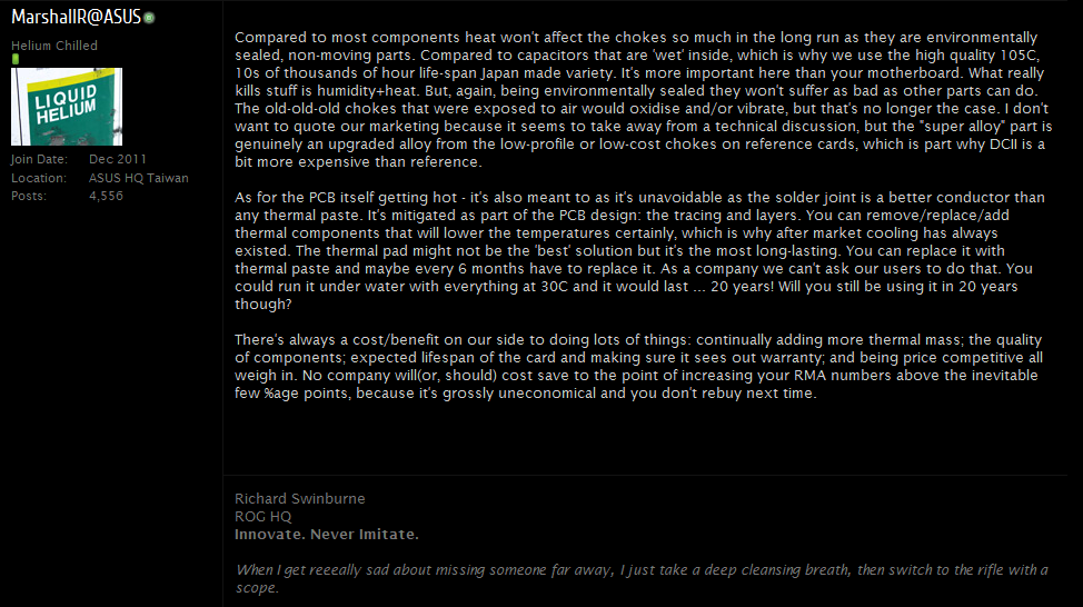

Not sure on your pic but I am going by that Guru is measuring the correct VRM area for those temps with their TC. The ASUS rep says its a wrong sensor reading but Guru shows with their TC the temp to be around 100c. I don't know the Asus card well or VRM placement on the board but right now I am leaning to Gurus' finding at this point imo

The previous Asus reply came from here after googling which refers to the R9 290 which isn't the same card as the 780ti.
http://www.kitguru.net/components/g...-direct-cu-ii-oc-review-1600p-ultra-hd-4k/28/
The Asus rep explained that the sensor is not placed correct next to the vrm and max ir temp in guru3d could be picking up the max temperature of some other component (don't know if that sounds plausible). That could be easily verified by eyeballing if the sensor is visible on the pcb. The rep didn't explain why the core gpu temps are lowered by an offset though.
I don't know sounds like a little tricky talk going on imo but I could be wrong. I am going on Guru TC pics so even if the sensor is misplaced they are still getting a high reading. I first read on that forum that the sensor was reading the temps incorrectly not that it was misplaced I believe.
