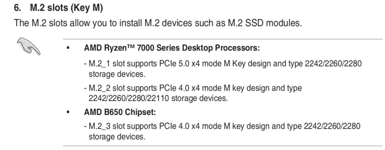

CrystalDiskInfo reports one of the drives running at PCIe 4 x4, the other at PCIe 4 x2. I've tried switching the sockets they're connected to, the one in M2_2 went to M2_1, and M2_3 went to M2_2.
From the manual:

Have you tried m2_1 and m2_3? If you use that orientation it should be using 4 chipset and 4 cpu? Maybe m2_2 is limited to 2 lanes due to the installed cpu.
Argh. That'll be it. 8500G. I'll switch M2_2 to M2_3 and that will hopefully resolve it.
Yup, tried that setup and I'm getting PCIe 4 x4 on both drives. Now to do a benchmark... the figures aren't maxing out PCIe 4.0 but they are a significant improvement (ie. well over 3GB/sec, when they were flattening out at 3GB/sec before).
