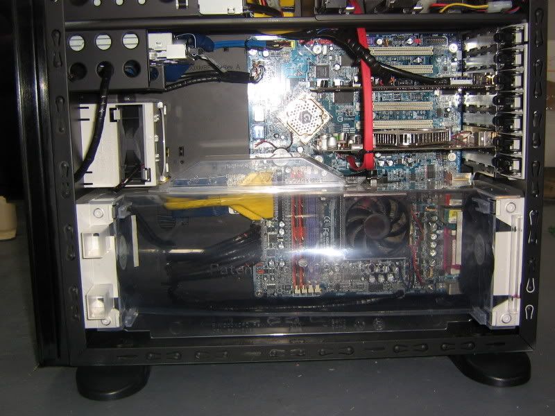

TJ06 with Wind Tunnel
The new board hopefully positions the cpu area more centered than my current board. With some foam padding, I should be able to totally isolate air through the tunnel separate from the chamber above.

Holy crap, I love it. That would also serve to prevent hot GPUs from heating the CPU, wouldn't it? such a shame my case can't do anything like that...
SolMiester
Dec 19, 2004
5,330
17
Yeah, its an old design now, only 80mm front for middle chamber but that can be fixed. Needed another exhaust behind the HDD in top chamber but its a very good case now....
