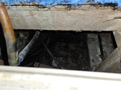

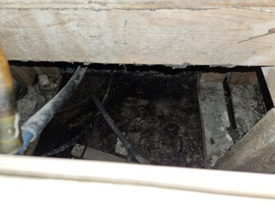

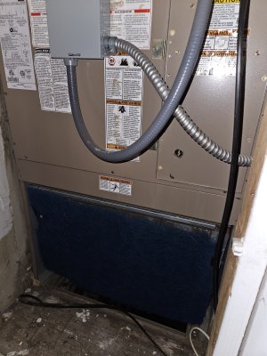

So i've lived in my apartment for about 6 years now. It has a combo AC/Heating unit inside the closet. Lately when i turn the AC on it's a very musty mildewy odor coming from it.
So i'm sure the condenser coils needs to be cleaned but what about the water in the crawlspace below it?
Here's some pictures i took of the unit:

looks like the condensate drain is leaking. yes, it needs to get fixed and cleaned up.

Perhaps I'm not understanding the pictures, but it looks to me like that unit draws moldy air from the crawl space instead of a return system?

Bonus, it makes it's own mold from the condensate dripping without a pan. Free mold!

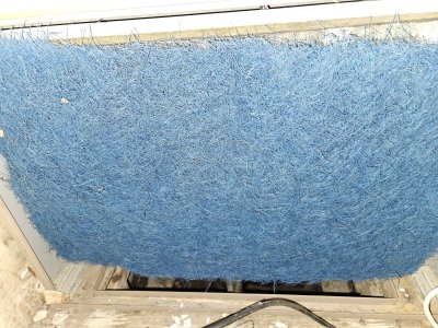

It's a bit hard to verify from the photos because of how dark the "floor" is. In the first photo, the blue filter should be between the bottom of the unit and the finished floor/subfloor. So there is no return "duct" but it draws air from inside the dwelling.
However I agree the subsequent photos make it look like there is no subfloor...but maybe it is just soaked with water hence the dark appearance.

Ugh, that's nasty. As others have said, the condensation from the evaporator is not making it outside unit for whatever reason. Could be something as simple as a clogged drain. I'd want to put a HEPA filter on there ASAP if it must be run in this condition, there are undoubtedly spores in the air you are breathing.
Honestly I would consider living with the heat, or renting a window A/C until this is addressed.
