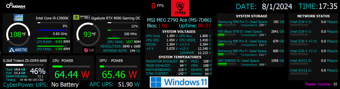

I have a Thermaltake Level 20 XT case which is akin to a fish tank size wise and the temps are the best I've ever had in any machine. Here's a snapshot from my sensor panel.
