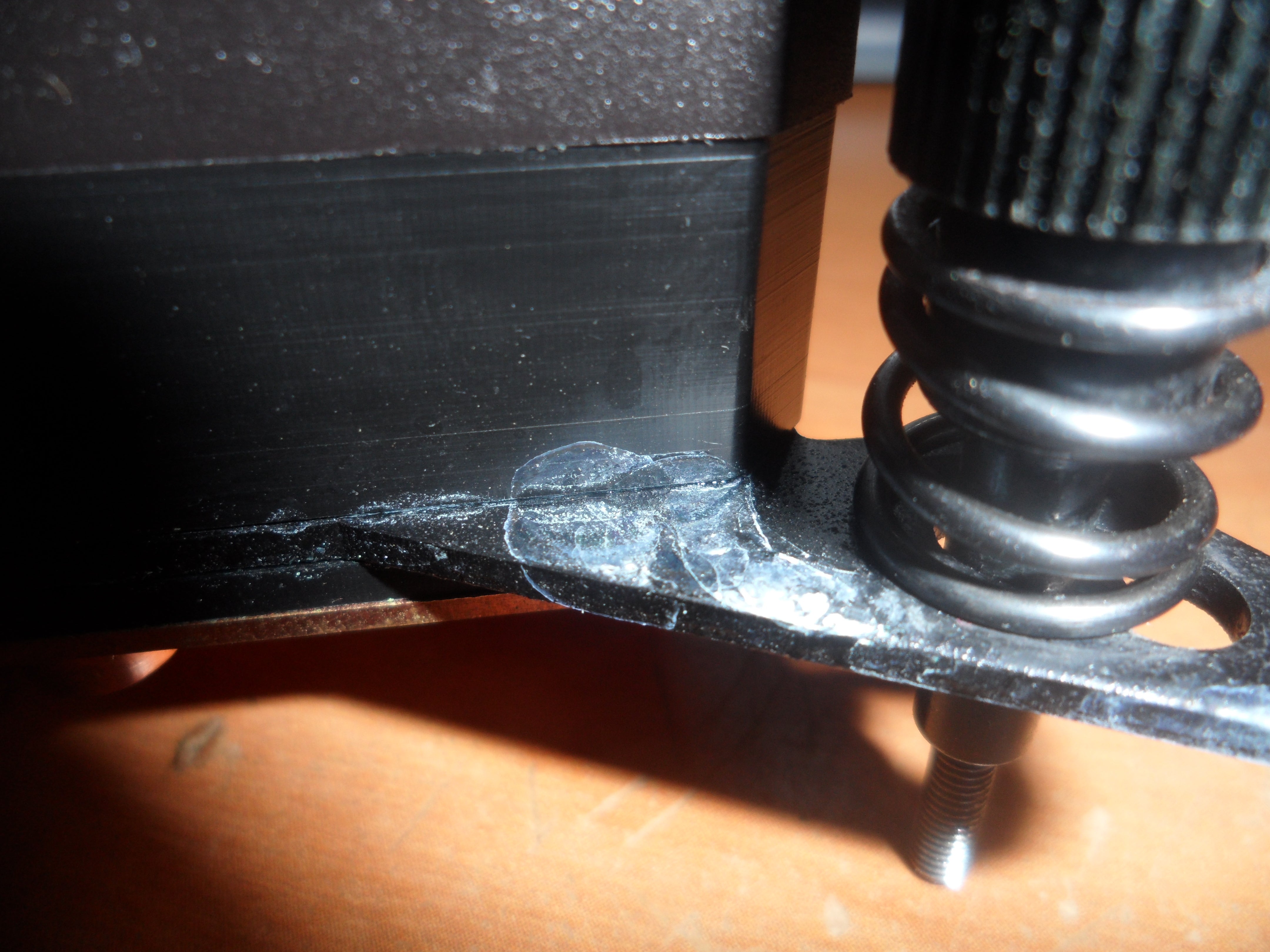

Leak tested for a week,,
System been running since about march...

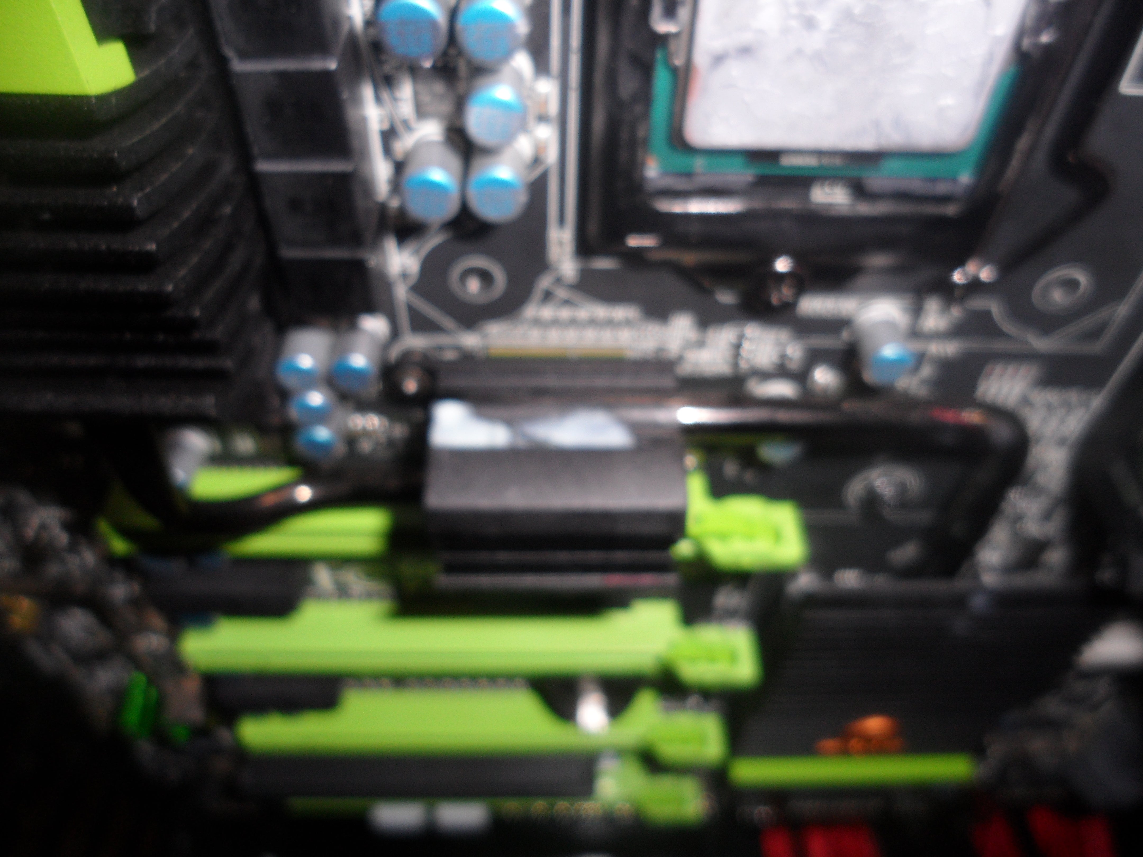

Came in room system was off would not power on then i noticed a puddle in the bottom of my case... Then found a leak on the Block...
So far tested all 3 gpus and psu all still alive..
Still have mb/cpu/ram to test.
Good to see the GPU's and PSU are still working. That looks like a Z77 M1 Sniper board. I hope it still works. Worst case, their is someone by the name of Xponential on these forums that is selling a brand new one for $200 if you needed another. That also looks like the same block from the new H220 - I was going to get one, but I have been hearing they been having a lot of issues with them and now seeing this ... 😱 Sorry bud

Seems like the oring on the pump drive wasnt secure properly.

that doesnt sound right at the leak spot he's pointing.
That is clearly a oring fault.

But a oring to degrade on that nature means it must of gotten in contact with alcohol or some form of ether type solution.

Never Took the pump apart ran distilled silver and pt nuke.
Swiftech has it now and im waiting word as to why it failed.
It looks like a defect that blew out somewhere to me...
I leak tested for a week.. and the loop was running for months till this happend.

everything seemed to work.. Besides the back plate on one of my Gpus now seemes to short it out...
I took the pads off of it now it works but running 7 c hotter then before...
