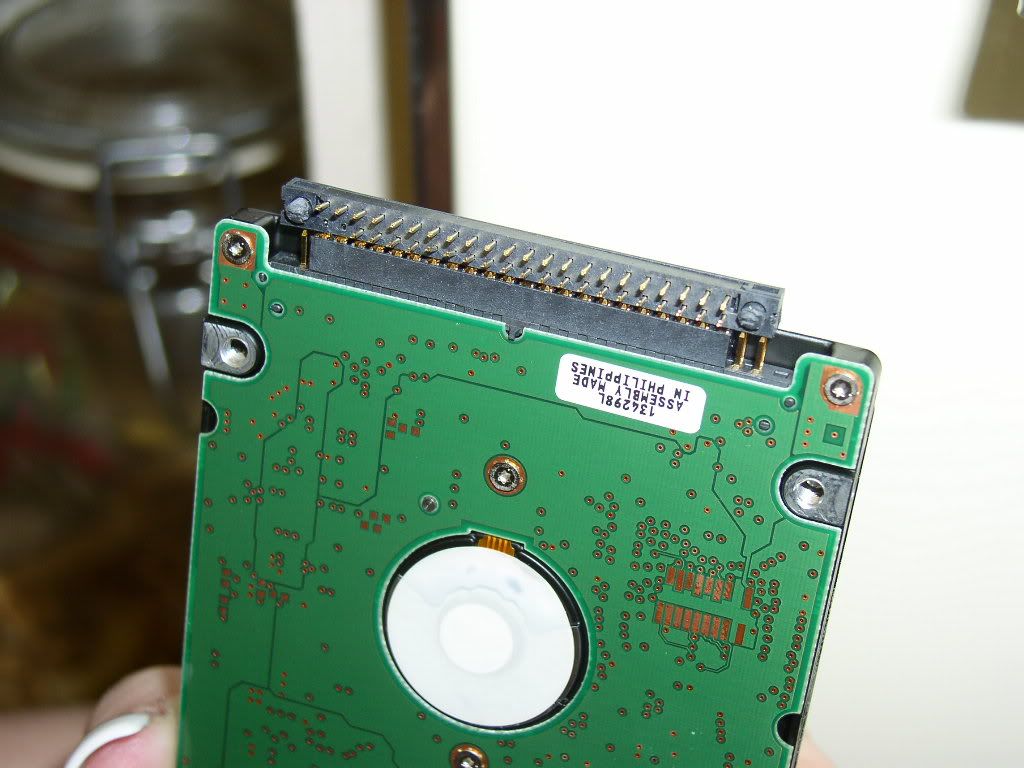

I opened up the notebook and the connecter faces upward from the motherboard and the hard drive sits flat on the motherboard with the pins of the hard drive facing straight down.

HP's should use a standard 2.5" HD. However, they may use an adapter on the HD to fit their notebook design (which sounds like what's happening in your case). I have made the mistake of installing notebook HD's in the past without replacing the pin adapter. Can we get a snapshot of the HD and the pin area you're talking about with the downward facing pins?

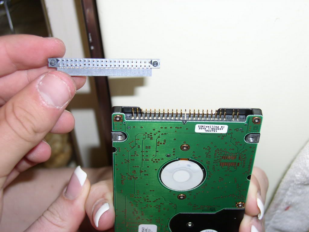

Unfortunately, I think there are some pins missing on the adapter so I think I'm gonna wanna buy a new one just in case. Where can I get one from?

I know how to switch out the hard drive, but my point is, I think the adapter is broken, there are two pins that are broken off. Can I find the adapter on EBAY?

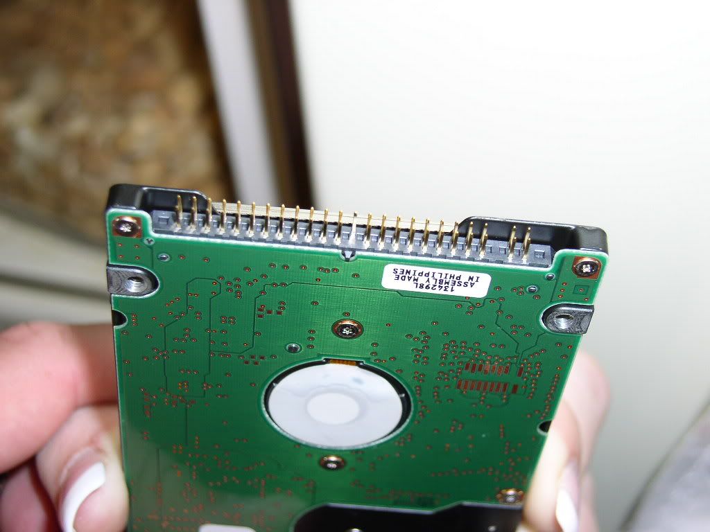

That's not possible in the 90 degree change adapter I have. It has no pins that can be broken. It has a set of holes that slip onto the hard drive leaving the left two pins of the drive exposed.
I will post another photo close up of just the adapter.
7
What you see are tiny pairs of wires that are actually sockets that embrace the pins that face up in the bottom of the drive bay. (Picture 3) The adapter sockets receive the pins in the laptop HDD bay just by sitting on them, and then held down by 2 screws as shown in picture 2.
Picture 4 shows it in place pushed down over the HDD pins.
I don't think you'll find this on E-Bay. H-P will not sell it as a part, but if you are under warranty, and it is broken, they will replace the entire drive assembly.

Did they break you pulled the hard drive? If you pulled the hard drive and they were as they are now and no one touched them before you shouldn't have an issue. I don't know of the adaptors on eBay. Sorry!

Hi Matt, If the adaptor worked with the old drive chances are excelent that it will work with the new drive. Unused pins are often left out. One near the middle acts as a key to keep you from plugging the connectors in wrong. Luck, Jim
