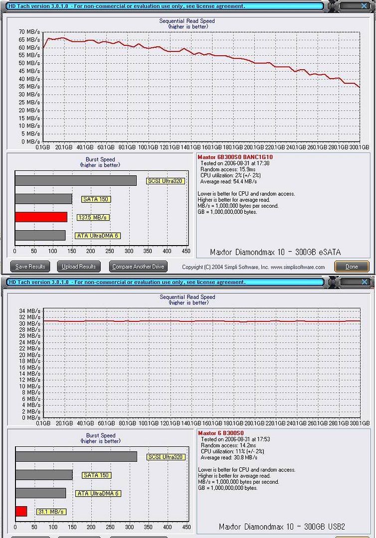

I tested my 300GB (60gb free space) Maxtor Diamondmax 10 SATA hd in a Vantec Nexstar3 eSATA/USB2 case first with the eSATA connection (to an internal SATA->eSATA bracket connected to my mobo) and then with the USB2 connector. Here are the HDTACH quickbench results, eSATA on top and USB2 beneath that.
