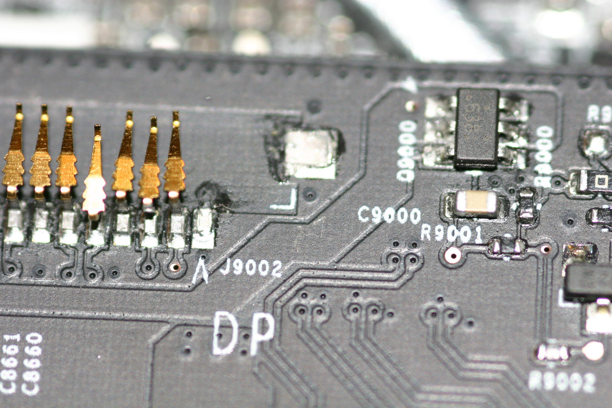

hi guys just wanted a bit of advice i got a curcuite board and the connector has broken off i have a new connector to solder on however just want to advize please best way to tackle it.
i have noticed the connector pads where the connector broke off have are a dirty grey in colour and from my experience dirty grey connection are very hard to resolder too.
also what would be the ideal temps to use on hot air & soldering station.
i have a hot air station as well as a temp controlled soldering station.
have flux paist also a rosin core flux pen & no clean flux pen.
heres a closeup of the dirty connections.
anyone please advize best way to tackle it or any other thing which i would need or would help in the resoldering of new connector as they are very small connections and you have to be very carefull to not lift the pads with too much heat.

i think soldering by hand wont be possible as these pins are very very small i took the pictures with my macro lense so they look quite big.

If i am not mistaken, on the right of this picture, there a component in a SOT23 casing. Above R9002. i am guessing but most of the resistors seem to be 0402 (especially R9002).
That is indeed small. But the connector solderpads spacing is about a 0402 length size. Thus with a new fine tip for the solder iron it should be possible. I advise to use solderpaste in these cases instead of solder wire. I do it myself as well and it makes life easy because it is solder with very good flux inside it. Use good forced ventilation because it will damage the insides of your nose, sinuses and lungs... I think you get the picture.

hi guys just a update to this thread.
i have managed to get the new connector on but im haveing problems soldering the little pins :'(
the legs on the new connector just wont solder to the curcuit pads i have managed to get 1 leg soldered but the other just wont make a good contact.
i cleaned the area free of old solder and wicked the old solder off the pads and cleaned with isopropyl alcohol.
then soldered the new connector into place by the 2 ground pads.
i just used amtech RMA-223-TPF Clean Flux paist .along the connector pins. useing a fine tip soldering iron set at 330 degrees and gently touched each pin.
after i went over them twice they still have not made a good contact.
i then tryed my hotair station.
again i used amtech RMA-223-TPF Clean Flux paist but no go.
and i also tryed a flux pen and heated the pins then i allowed it to cool but the connector pins are still not making a contact ??
im stumped why the new connector pins are not soldering to the curcuit pads as ive used
amtech RMA-223-TPF Clean Flux paist also tryed a no clean flux pen and also rosin core flux pen.
the pins just wont stick or flow.

you wicked the old solder off, did you add a little dab of solder until it flowed into the gap when you heated the contacts?
Are you mixing leaded and lead free products ?
Leaded solder products don't work too well with the lead free products. Sometimes using leaded solder with lead free soldered products results in solder joints that don't form well. Sometimes you have to increase the heat significantly to get a good bond. Make sure the flux you are using is compatible with the solder and the board. Some flux doesn't work well with lead free.
^^ There should not be a gap, connector pin should sit on the pad, having squished out solder paste applied before the part was tacked down. If the pin is not sitting on the pad, it could help to use a probe (I used a set of picks that look like dental tools) to hold it down while soldering. It helps if the probe is a less reactive metal like stainless that is polished so it is less likely to become part of the solder joint... but not entirely necessary depending on the situation and space available.
Which is the solder not wetting properly? PCB or connector? Either there was excessive residue remaining on that part, or the two were not in contact so your iron is only heating up one of them, or your solder paste's flux is shot (old/dried out/etc). Also make sure your iron tip is clean and uniformly wet with solder.
I realize it is hard to get a good macro of this but a good picture focusing on a typical failed joint (need not try to show all of them in one picture) might help.

if i'm reading through OPs postings right - i don't think he's using any solder paste, just flux in paste form.
OP, you've removed the solder, you need to add solder, the flux is just there to help it adhere to the surfaces.

Is this what is being used? Should be easy to tell by color, if it's gray it has solder balls in it.
The pins you are attaching are not that small. Forget the paste. Get some small diameter solder and use some flux. I thought we were talking about really tiny stuff, I have done smd chips with 48 pins using solder so pins that large shouldn't be a problem.
hi mate i have tryed useing solder with a fine tip but keep bridging the pins. and i haveing to keep wicking it off
Solder and then use wick to clean it up. Done all the time with surface mount circuits. Some people even flood all the pins with a blob of solder then wick up the excess being careful not to remove all of the solder from the connection.

This is what I would do as well. Generally the solder doesn't really want to stay on the non-pad portions of the PCB (the technical term escapes me at the moment) since it is not as hot as the actual solder pads (which makes sense since the pads are conductors and the plastic mesh of the board is an insulator).

three things you need: small tip, small solder, big flux
