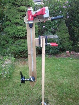

No, I think he's on the right track, just need to rig a prop onto the blender motor and figure out how to wire an electrical outlet into the boat.
If it can be done with an 18v drill then why not a 120v 5hp commercial blender?
Obviously there's a transformer and such inside to run the DC motor...once you take it apart you should be able to figure out how to power it cordless. :twisted:
