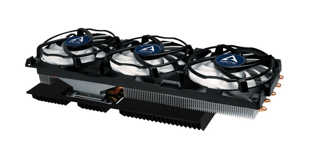

An open bench case might work in a large A/V cabinet or closet as well. I have a friend who has a lian li open bench with a pair of Titan Xps. He replaced the stock cooler with Artic Accelero IV's, removed the fans, and blows a low rpm 360mm on over the heatsinks, and threw the entire thing in a giant A/V cabinet.
If you absolutely don't care about looks, there's ways to get complete silence. Looks, small form factor, and silence with no liquid cooling, then I don't think you can really do much better than use some very low rpm fans and run stock clocks like the system I run.
