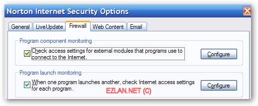

Norton have this type of controls over secondary Modules (like explorer.exe), http://www.ezlan.net/example/
Might be that McAfee handles it differently and thus the sudden popups.
