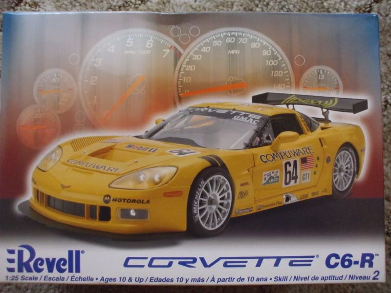

update:
This is the model im working on.

Im building a small scale Corvette. I dont even know the model of it. Its some corvette that won a bunch of races in 05 and 06. Yellow and black all souped up and the like.
Ill see if i can get pictures or something.
