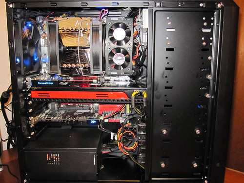

Yeah the cable management can be a bit of a pain, but with a little bit of modding you can get it super clean :). airflow is brilliant and the case looks great. The fans can be a bit loud on high, but I doubt you'd need to set them that high. The top 200mm Big Boy is thin btw, so don't go near it while it's spinning...lots of cases where it broke because somebody accidentally stuck his knuckle in it.
http://i233.photobucket.com/albums/ee257/pikeruinhisigloo/IMAGE_130.jpg
