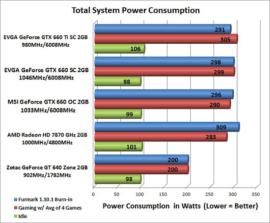

SSDs barely use any power and HDDs use maybe 12 watts tops. HDDs should have a volt and amperage rating on the label on the disk itself.
The TX750 is certified by Nvidia themselves to run dual SLI for the GTX 560 Ti(older, which means more of a guzzler). It has 62 amps on the 12v rail, so that means 744 watts can be sent on the 12 volt rail. That is well above what a GTX 660 SLI config will draw.
PSU calculators usually overstate wattage values.
Your MSI GPU was benchmarked here: http://www.legitreviews.com/article/2023/11/
This is total system power consumption, so the 3960X processor and other components also use up power. I'd say about 170 watts is due to the GPU(wild guess on my part), so 460 watts at the wall is my estimate if the GPU was SLI'd.
But PSUs are rated for what is actually delivered to components, not at the wall. Some AC power is not converted into DC power; this is where efficiency comes in. Assuming 87% efficiency, since the review used a Corsair AX1200, the I would estimate that whole system in that review would pull 400 watts if there were GTX 660s in SLI.
