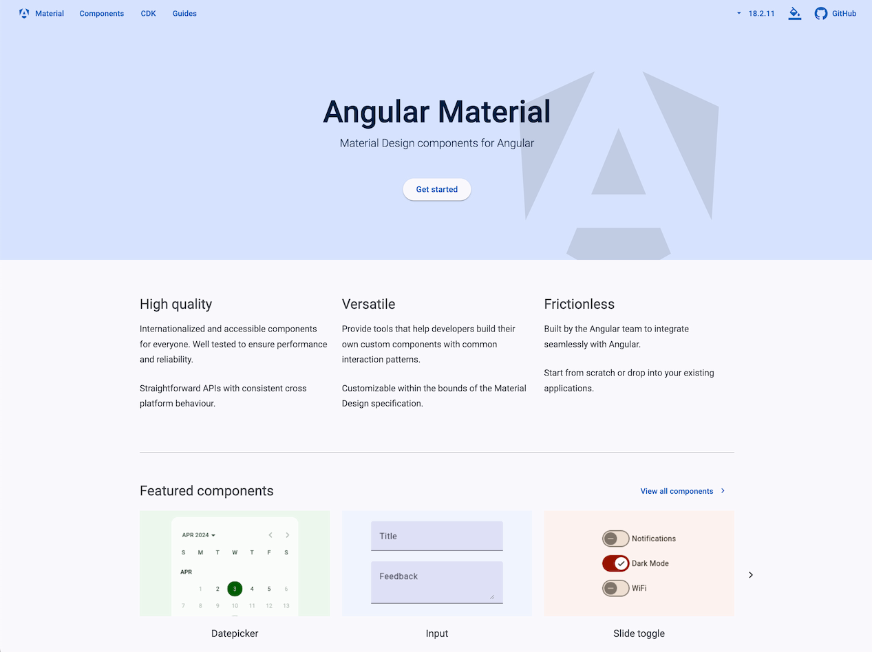

I just tried the first example here:
In my app and it worked fine. I copy/pasted the HTML from that example and added MatDatepickerModule and MatNativeDateModule to my app.module.ts imports block and it worked fine for me.
