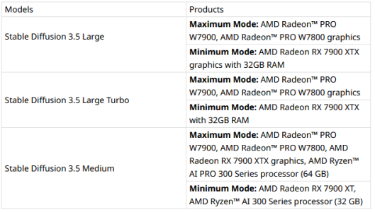

From the support matrix: AMD Ryzen™ AI PRO 300 Series processor (64 GB)
Strix Halo???
By the way, does the Maximum mode refuse to work with a 7900 XTX? Can anyone confirm?

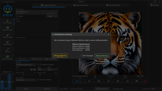

I'm going to assume the 7900XTX doesn't have enough VRAM for Large & Large Turbo but is fine at Medium.
I can test in abit.
*Update*
So when I load the Large model I get this warning.
You can force it to use Maximum but that wants 38GB
I got it running but its dirt slow due to lack of VRAM.

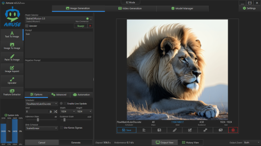

The Tiger above was generated in 63 seconds when using Medium.
The Lion below was generated in 506 seconds using Large.
