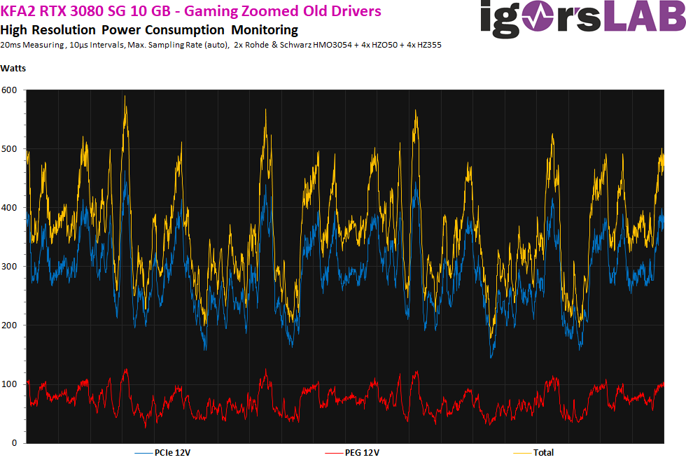

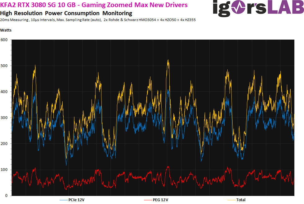

Seems it's less than that, and power draw difference isn't much and might even draw less. Doesn't mean it doesn't look real bad they had to do this.
If you compare the readings that they got the old drivers would see spikes in the power draw up to 600W for very small amounts of time:
Compared with the new drivers, it seems like the card rarely pushes much above 500W now:
That's a probably 80W or more in terms of difference. I wonder then if it's just an issue of people with a good power supply that isn't quite good enough, particularly if coupled with a lot of other hungry components.
The changes aren't going to be perceivable based on the limited testing they did with the Witcher 3. I doubt anyone notices going from 99.9% of all frames being delivered in under 4ms, to only 99.8% of frames being delivered in under 4ms.
I'm not too concerned with how they look over having to fix the problem in the first place when they did a good job of fixing it so quickly and about as painlessly as possible.
Any decent PSU should be able to handle momentary transients like that, but beyond that people with 1+ KW power supplies were reporting crashing issues as well, so I don't think the issue was power supply related, although some with lower rated PSUs may have had issues as well.
