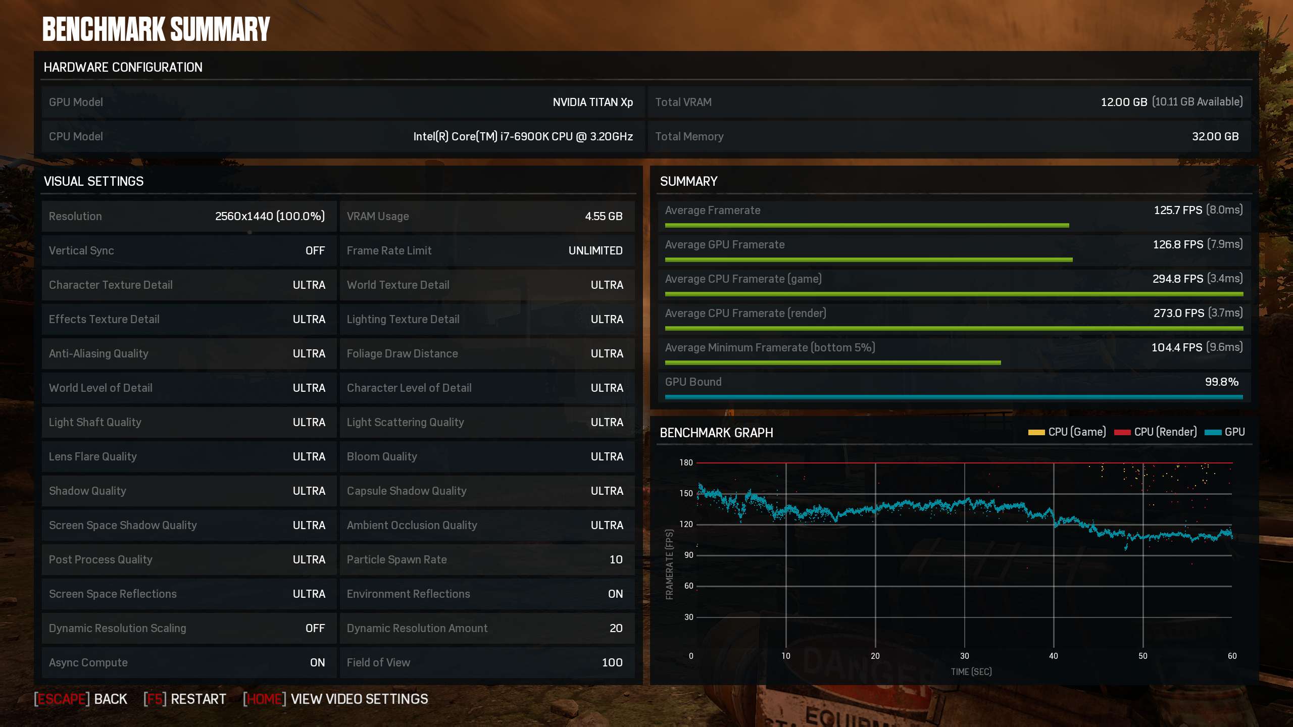

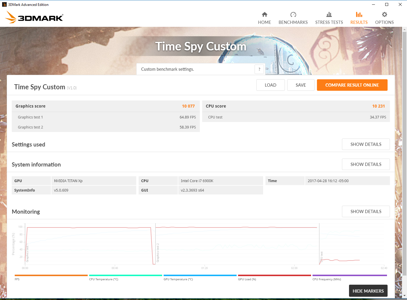

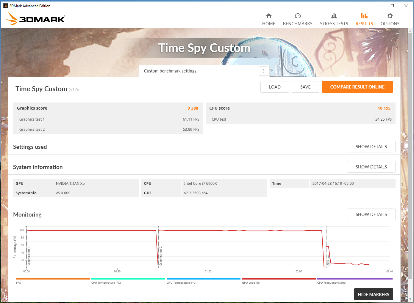

I'm just curious to compare AMD vs NVidia asynchronous compute performance. Gears of War 4 is an ideal game to test asynchronous compute and it's performance benefits since you can toggle the setting and it supports both AMD and NVidia GPUs; and not to mention the implementation is quite robust by any standard. Sniper Elite 4 is supposedly another game that uses asynchronous compute fairly well for both vendors, but I don't have that game.
Here's two runs using the same 1440p ultra settings, but with Async compute on and with it off. Average GPU framerate had a minimal increase, but when you look at the line graph, you'll see that the framerate was much steadier with less dips. The biggest increase was in the CPU framerate rendering time, which had a nearly 16% improvement with asynchronous compute on, compared to with it off.
I'm very curious to see how the AMD cards do in this benchmark in particular. Also, I do NOT recommend using MSI Afterburner and RTSS to do any monitoring in Gears of War 4, because from my experience, it actually reduces performance. Yes this can occur in some games because of the overlay for the OSD.
So if anyone has Gears of War 4 or Sniper Elite 4 and wants to post some benchmarks or screenshots with it on and off, and discuss, go ahead please :D
Async Compute off:
Async Compute on:

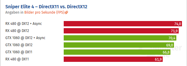

About 7.3% gain, which isn't bad for not having dedicated asynchronous compute engines.
I theorize that as AMD's shader arrays become more efficient, the performance increase from asynchronous compute will be much less than what they're getting now with Fiji.
The 480 gets 12% gain in the image I posted above.
