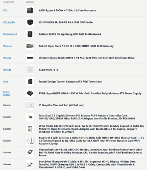

I guess I'll give you what you want in terms of config / build....
A lot of this is a port over from the current build or spare parts since some things won't work with current Intel but might/do with AMD. Which just sparked an idea to check something that became an issue with ADL and beyond... I'm also switching the networking from my 5GE quad port card to the 2.5 dual port to save space and if the TB networking works properly there's no need for 5GE when I can get 40GE from the cable. If my idea that just came to me to check something for compatibility could eliminate one of the ETH port needs which changes things a bit and might sway me to just putting a couple of 10GE ports inside for the network side. There's so many options though to find the balance between performance / needs / cost. If the option works swapping that 2.5 card for a 10GE will make some sense in terms of raising the baseline network speed when needed as ISPs keep bumping the speed limit upwards as time goes by.
