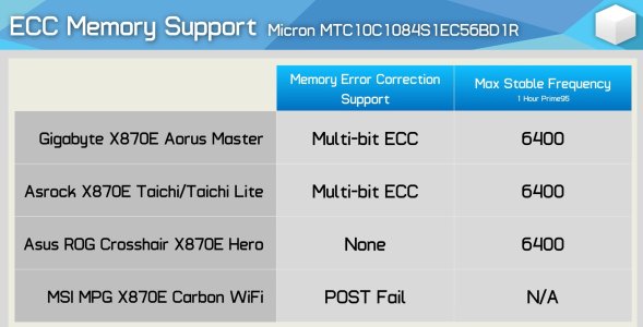

A couple of the new X870e boards have it
I am certain there will be more, if not at launch, via bios update. I also agree the board makers should make it easy for clients to find the info.
