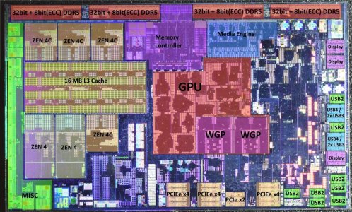

I wonder how far they considered taking this approach (phx2). Did they internally test a version with 2+6(16)? Did they consider the possibility of making a flagship H series with a 4 core z4 cluster and an 8 core Z4c cluster with a 2CU iGPU? That could have been an MT monster.

So do we consider this AMD's first hybrid chip or not? I'm still confused about Ian's stance not considering Little Phoenix and claiming AMD hybrid chips are still way out.
I wouldn't considering there's no difference between the cores from an ISA perspective. They're not as different as Intel's P and E cores and probably much closer to the usual differences that AMD has had in their Zen cores across different products and nodes.
SteinFG
Dec 29, 2021
743
873
It's easier to make the cheapest die a market will bear and a good part that can be used anywhere, regardless if it's connected to the gpu or not. So the answer to your question is almost certainly no.

Lovely!
So a shared cache between all the cores automatically gives them a higher cache hit rate rather than trying to transfer data over the ring bus like the stupid separate Intel P-core/E-core cluster mess. Is my understanding correct?
Why are you surprised?
Did you forget that Zen1(+) had 4+4(2*CCX) cores per chip, Zen2 had 4+4(2*CCX) per CCD and had two of them.
Zen3 increased core count per CCX to 8 instead of 4.
tamz_msc
Jan 5, 2017
3,865
3,730
Lovely!
Zen 3 onwards uses a bidirectional ring-bus too.
28,174
19,218
What I'm referring to is that there aren't multiple CCDs so intercore communication latency should be much less between the Zen 4 fat cores and Zen4c tiny cores. Imagine if they had done the Intel bone-headed way of having one CCD for fat cores and one for tiny cores.

I'm pleasantly surprised that they did the logical thing instead of doing the dumb thing of creating separate clusters of Zen 4 and Zen 4c cores, automatically raising the communication latency between the dissimilar core clusters.
I kinda don't understand why you even thought that they will do the dumb option?

Because knowing only about the Intel way, I didn't know before what the clever way of going about it would be :)
AMD is also using ring bus and shared L3 like Intel. So the Intel way is the correct way. The wrong way is(was) the AMD way of using separate clusters.:p
28,174
19,218
L3 in Raptor is also shared between P and E-cores.
It's shared between P-cores and "cluster" of E-cores. All four e-cores of a cluster are not directly connected to the L3. There has to be an additional latency or some agent that has to ensure that the received data from the L3 lands on the correct one of the four E-cores. There is more overhead in the Intel way. At least, that's what it seems like to me.
TESKATLIPOKA
May 1, 2020
2,696
3,260
There is, as is when AMD is using separate CCDs + IOD on top of that.
So what's the big deal about It?
