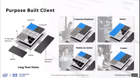

Exist50
Aug 18, 2016
2,452
3,106
AMD APUs are by far the worst example of modularity - basically none as far as re-using dies. This is costly and it sucks / wastes resources.
The other end of the spectrum, modularity and re-usability - modularity nirvana - would have CPU CCD dies that are shared with desktop and server and GPU GCD dies that are shared with dGPUs.
IMO, the ultimate goal for AMD is to reach this nirvana.
We will see if either Strix Halo or RDNA 4 offer us any clues of how AMD is planning on getting there...
I think the ultimate goal would be similar to this graphic that (somewhat ironically) Intel showed some years back. Not just CCD level granularity, but core level granularity.
Of course, practically speaking, there are a whole host of challenges to such an idea, and it's for many of the same reasons that you don't see 100% reuse of dies even today. There're always going to be tradeoffs that make sense for one market but not another.
Like, you call the monolithic APU dies a waste, but clearly Dragon Range shows there are challenges with just reusing their existing compute dies. Mobile is certainly high enough volume to justify the extra design/manufacturing effort. Maybe future packaging breakthroughs can help close the gap.

Doug S
Feb 8, 2020
3,843
6,797
In my opinion the main thing about modularization is the tradeoff between die size and overhead, i.e. area needed for additional I/O necessary to connect the broken up dies. AMD stated that with Zeppelin the overhead was ~10% that could have been saved going monolith. With SPR with its abundant use of EMIB the overhead is around ~21%.
So the smaller the pieces, the more pieces, and/or the faster the interconnect the bigger the overhead likely is to be.
APUs for mobile are ideally small in area for mass production, power efficiency and cost. Whether there truly ever is a chiplet strategy that works well within those limits remains to be seen. Personally I expect monolithic dies to remain relevant at the lowest end. The product range split between Phoenix and Dragon Range already shows where that line may be drawn even in the future.
Two monolithic dies (one smaller one bigger) would serve 90% of PC buyers. The modular solutions really only make sense for those in the niches, and even then I'm skeptical whether a corporate power user is all that different from a gamer or creator. And who the hell knows what a "mobile go-getter" is lol
They try to show some sort of usefulness for this modularity in tailoring specific solutions, but whoever did it obviously doesn't understand their markets at all. Why would corporate users want on chip AI? Whereas individuals with privacy concerns want AI to be done locally rather than in the cloud, that objection doesn't exist for corporate users. Their IT department would have them do all their AI tasks in the corporate cloud, and save money buying PCs for every employee without any on chip AI that would sit idle 99.99% of the time. They will want those AI tiles on their server CPUs, not client CPUs.
And why do they show a gamer with all GPU/CPU and no AI or I/O? They don't need AI cores today because they don't have them so games aren't written to use them. I wonder, do iOS games use the NPU at all? I'd be surprised if there weren't a few big name games that do...because they can count on it being there in every single iPhone sold in the past half decade or so. If gamers start buying CPUs with AI cores someone will write a game that exploits that resource.
