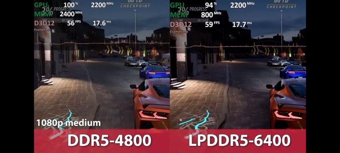

Here's 680M w/ DDR5-4800 vs LPDDR5-6400:
And we're supposed to believe it matters LESS for 780M, when it's not even using natively supported 5600 in all of these so called reviews, let alone LPDDR5 or 5X. lol

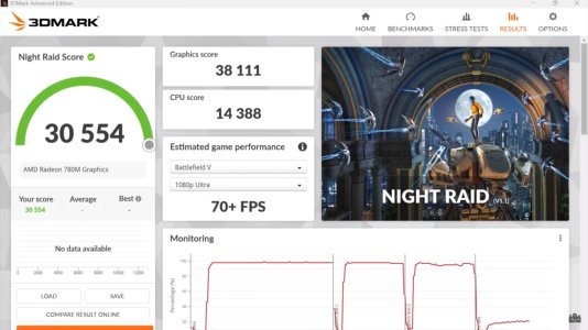

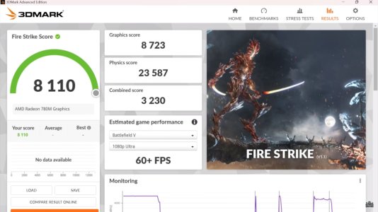

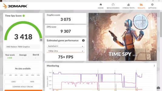

Case and point, ETA Prime has a review of a (7840U) 780M w/ LPDDR5X (synthetics @35W):

A serie of 780M tests can be found here:
From the same channel you linked, with 680M:
33% more memory bandwith for 3 FPS more.
Tell me what mythical ingredient RDNA3 has that it's gonna surpass that same deficit.
I'm waiting for your technical breakdown, o enlightened one.
