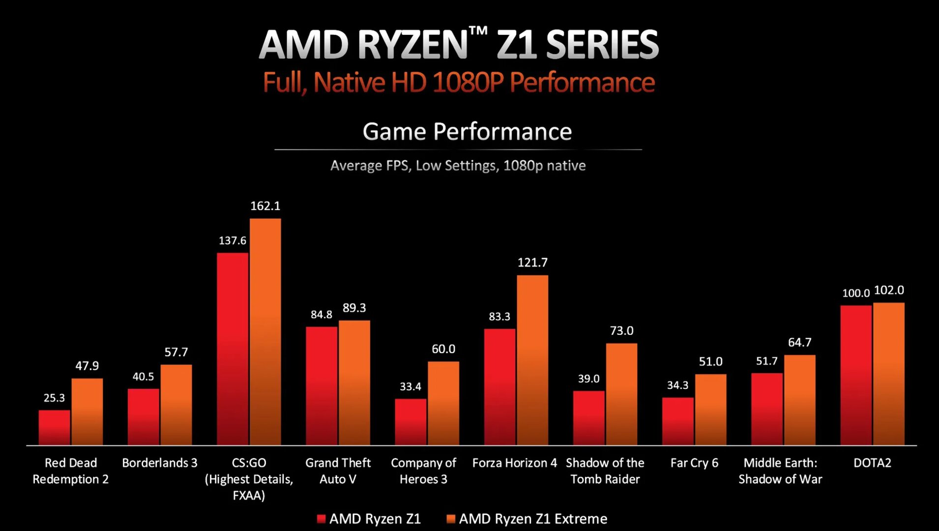

AMD gets official about Phoenix for handhelds:
Too bad they reduced the GPU so much on the basic one. Hope eventual 6-core DIY chips get bigger GPU than that.
There s this slide to add if it wasnt already posted :
Edit : They should had upgraded the lower part to 6 CUs.
That slide actually supports the argument that Z1E has too many CUs, not Z1 too few. Surprising little FPS difference between the two for a massive 3 times more CUs.

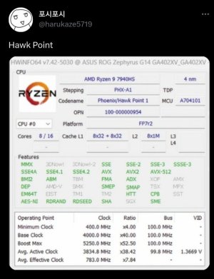

Looks like the Ryzen Z1 Extreme is a rebranded Ryzen 9 7940HS Phoenix at least the shown iGPU performance metric is exactly the same as the prediction I've posted a while ago. So the iGPU clockspeed must be the same.
But since this is for handheld the CPU clockspeed must be lower to improve battery endurance. I'm guessing it's ~4.75GHz 15-28W range. More importantly, pricing is key for these product's success. With more utilization of the same CPU we might see better pricing overall.
That slide is based on Full HD and low settings. High settings would be more interesting for a comparison or at least medium.
That s game dependent, there s some where it s 50-90% better perfs for the Z1E.

This is rumored Phoenix+, a refresh Phoenix Point with updated RDNA3+ graphics engine. The rest of specs should be similar with PP. So it is not Z1 SKU :p
Idk if Hawk Point is actually RDNA3+ or if it's just a renamed Phoenix, but in either case it should not be available yet. This is just PHX, the software there is just reporting PHX as both PHX/Hawk Point.
