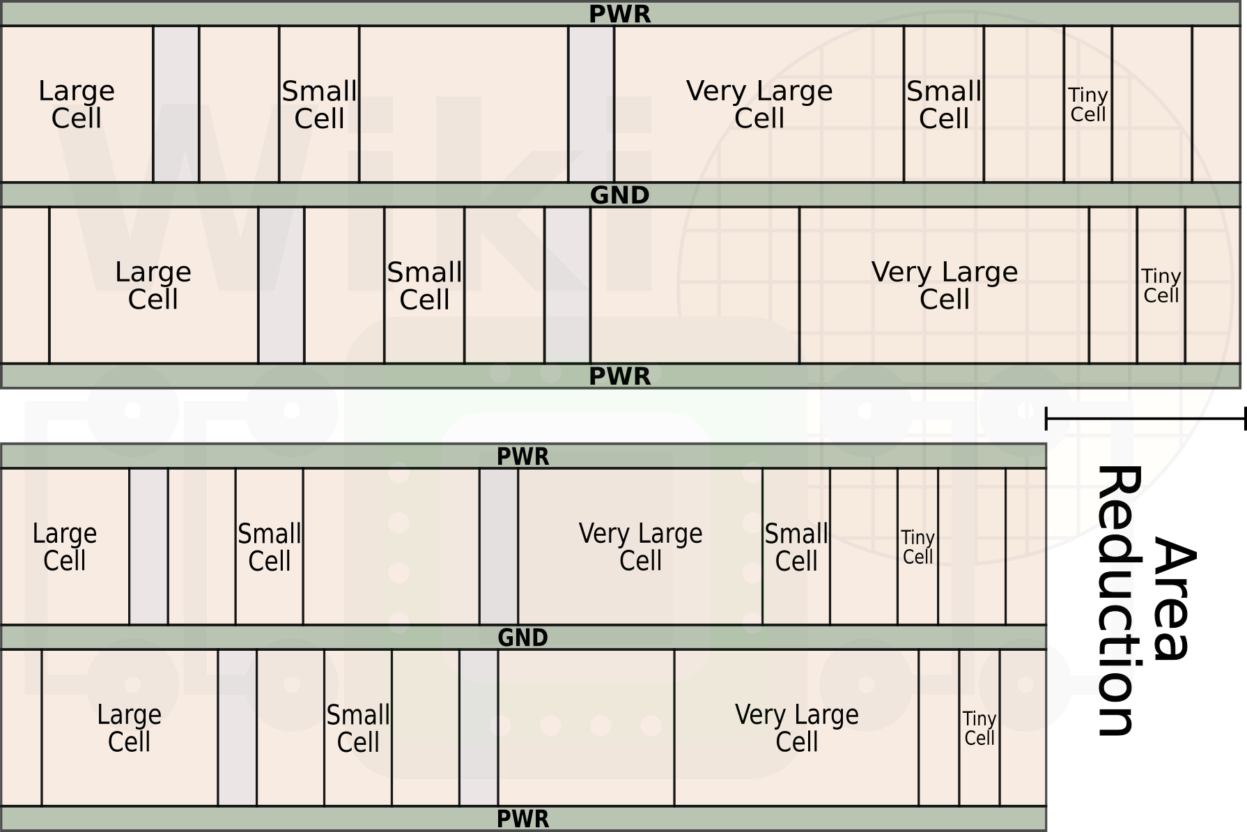

Okay decided to hop into this:
Zen4:
Standard HPC -> 75% of cells => 2x width/1x height
High-Speed HPC(DTCO knob) -> 25% of cells => greater than 2x width/1x height
Memories are custom high-current, SRAM = 8T HC.
Zen4-Dense:
Low-power HPC (DTCO knob) -> ?% of cells => ~1x width/1x height
Low-power/High-speed HPC (DTCO knob) -> ?% of cells => less than 2x width/1x height
Memories are mostly custom high-speed high-density, SRAM = 8T HSHD.
Probably have to wait for Athlon 700GE series. If there is one, to see when frequency gains requires exponential voltage growth and exotic cooling. Server offerings of Zen4 do not have the >5.5 GHz, nor do the mobile offerings go beyond >5.1 GHz like AM5 boards do. The highest max(SC) boost on Genoa is 4.4 GHz, while Mobile sees 5.1 GHz.
