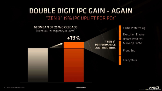

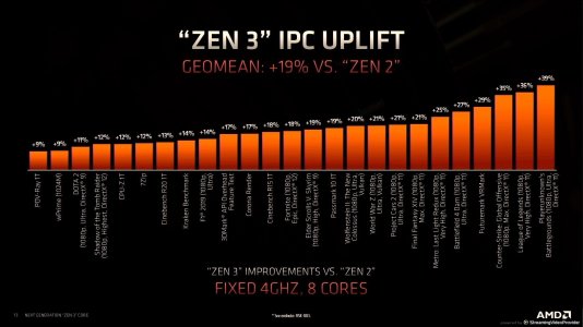

BTW, AMD apparently didn't disclose what the 25 workloads for their 19% figure were. Hence it is impossible to say if these workloads were largely insensitive to the CCX change. Only then would the left side of this slide correspond well with the right side of the slide. (End note R5K-003: See e.g. press release at amd.com.)

AMD actually did say which 25 workloads they tested.
I can see where better prefetching could be considering lowering latency, but that's clearly not what OneEng2 was talking about. Since he said the first generation chiplets were the issue and prefetching has nothing to do with chiplets.
Yeah that 19% IPC uplift is BS because it's heavily gaming focused, that's not what you do when you want to assess average IPC uplift across many applications.
Maybe it's truly 19% or so in Spec, but this test for sure was wrong if they wanted to show average IPC.
What kind of garbage post is this? 19% in games, 19% or so in SPEC, but it's all wrong if you look at "average IPC"?
It basically matched for Zen 3. But if you haven't realized by now AMD does their marketing numbers backward. Engineers say what they achieved in spec and then the marketing bros pick a bunch of benchmarks and games to put on the slide such that the geomean is around the target given.
It backfires tremendously when the SPEC and gaming results aren't close like Zen 5.
What I mean is that geomean chart is BS, you don't put like half of the workloads as games if you want to assess geomiean IPC.
