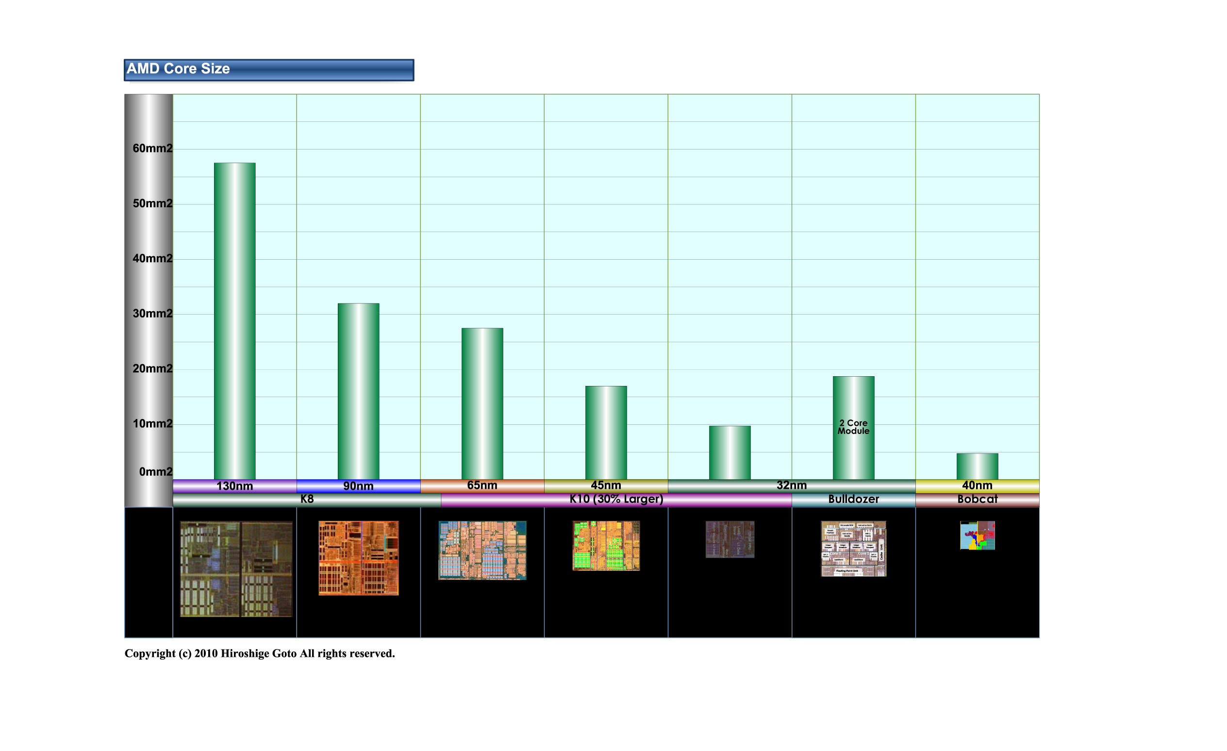

So a Llano core and cache is 17.7mm. A bulldozer module is 30.9mm.
So that is 75% larger to get the extra core in there.
That's impressive, I guess, although for some reason I expected it to be lower.
Has anyone figured out how much the total die size of bulldozer from those pictures and those numbers? Should be pretty straightforwards.
That's impressive, I guess, although I expected it to be lower.
bulldozer has twice the L2 as well

The 4 module, 8 core variant of Bulldozer, code-named Orochi is at 300mm2. Though the module requires nearly 2x the amount of space as single K10 core at the same process technology, the actual addition of the module itself isn't that big. The rest of the size increases have to do with the significantly expanded resources everywhere. In other words, straight up dual core Bulldozer with no sharing would be much larger than a single module.

AMD has said that BD will be released in H1 2011 (1 January to 30 June). So until 30th of June we are within the H1 2011 time frame.
We cannot compare Llanos core to BDs module, they are completely different architectures. Llano is K-10 derivative when BD is a new design.
At ~300mm2 its huge for 32nm in contrast to 220mm2 for SB and 239mm2 for Intels 6-core Gulftown.

Funny correlation - AMD's fortunes vs their core size.
Since the graph shows an increase in the BD core size (for a module), hopefully their financial position will follow.
