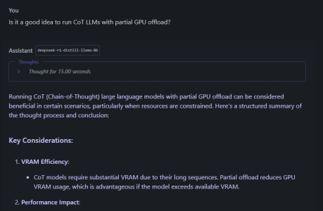

Here's how an R1 distill formulates an answer:
Notice the "thoughts" rectangle that takes 15s to complete in this case @ 50 tok/sec. With 20 tok/sec speed it would take 35s+. Writing speed is still good but delay before the first word has increased by 20 seconds on top of the first 15.
Obviously not all answer take this much "thinking", some are quite quick.

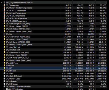

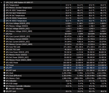

Here's how it looks at stock with a prompt that made it "think" a bit longer, the fan ramped up to 1100 rpm after the screenshot:
Here's my usual gaming underclock & undervolt:
At first sight the higher stock clocks don't seem to help inference speed much, though this is the first time I look at this. I would expect memory speed to help, obviously. Maybe also latency? Reminds me of crypto mining 😀

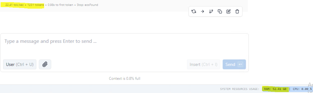

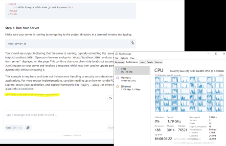

I was getting failure messages with Deepseek Coder Lite. Unloaded it, clicked to reload it in the top bar and it showed me settings. Maxed everything out and really love the result!
With that much RAM used for useful results, don't think any GPU will be of much use until maybe 5 years from now?
@Red Squirrel maybe now I can create that Xitter clone before you! 😛
What is the size of the model you are using? With 384GB, you could try large models.
Deepseek Coder Lite is 10GB which is almost useless at default settings. Max everything out and it balloons to 50+ GB in memory consumption but then it understands and thinks better and gives me exactly what I ask it. I think I'm fairly satisfied at the moment. Will try to be more adventurous once I hit a bump or something.
