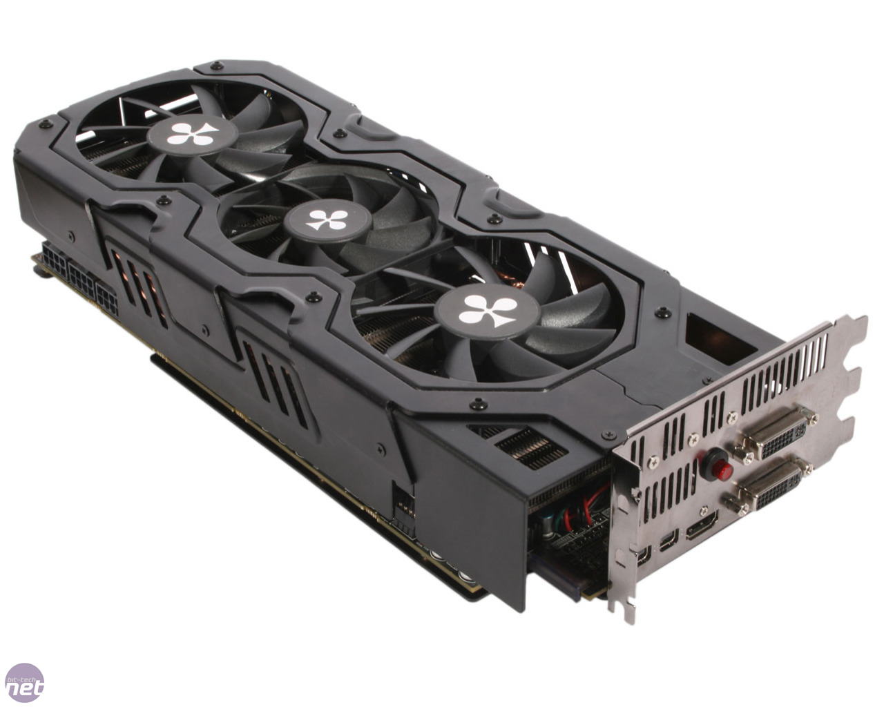

If it looks like this (or similar cooler):
it's the pre-AMD 7990 with 500W TDP.
