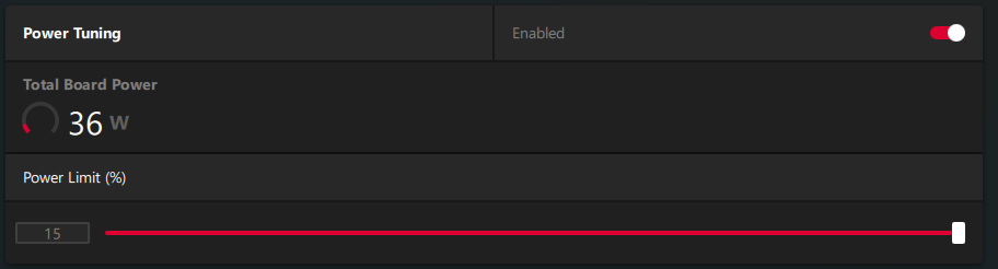

I ordered a Red Devil RX 7800XT. Since I don't really play games, the only thing I was trying to do is to take it to 3 GHz using Unigine Heaven Benchmark. Anybody knows how, I see there is lot of chatter of folks hitting 3GHz + with this card.
Max I was hitting is only 2650 MHz.
Will tinker around with ROCm on this card.
You look to be power limited. You are at 272W. So you either need to decrease the voltage to give you more power headroom or you need to enable power tuning and increase the power target. I'd go the voltage route as it will also help with temps. You may still need to increase the power target as well.

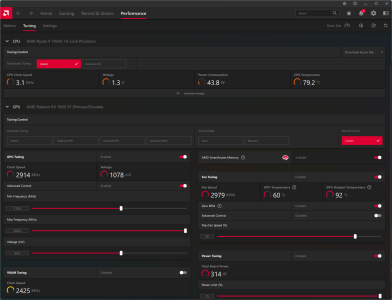

You are absolutely right my friend. My card seems capped at 314W. But I was hitting consistently around 2.9 - 2.95 GHz. Insane for a GPU with 60 CU. Fans started spinning a bit too fast though.
Power efficiency also didn't receive a hit, If those numbers are correct.
2530MHz(100%) vs 2914MHz(115%)
272W(100%) vs 314W(115%)
if It was 2650MHz at 272W, then 10% clockspeed for 15% more power draw. Still not bad.

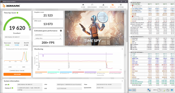

Does it pass the regular Time Spy at these settings (960mv Vgfxoff @ max power) ?
If it does, can you attach the HWInfo64 sensors screenshot running from the start of the test, like this (just for science :)):

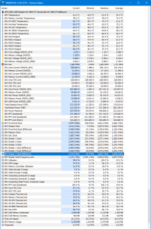

Unfortunately I don't have a license for Time Spy. I ran Unigine Heaven benchmark. I don't think it can sustain 2.9GHz on air, at least not on this BIOS.
I ran the Heaven benchmark for 30 mins or even more.
Card is Red Devil but reported as Hellhound. But it is very nice looking.
BTW, what is the TDP of the chip alone or TGP including memory.
For RDNA3, TBP is reported, for RDNA2 it is TDP I think
Thanks! This HWInfo screen has enough info, although I prefer Superposition from free benchmarks, 1080p Extreme preset.
The card is decent for the average user, but as for me I've lost any interest in this generation due to AMD's restricting user control over powerplay. Its performance is so crippled by this +15% power cap, that its water cooling makes almost no sense.
I think I wouldn't buy it (or 7900) even for half the price for the reasons above, lol.
@TESKATLIPOKA
TDP is equivalent of max TBP at stock settings and stock cooler. Starting from RDNA3 amd added TBP reporting.
TGP (same as PPT by AMD terminology) is TBP minus vrm + pcb losses and periphery power eg cooler, leds, etc.
