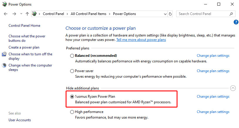

Changing the power plan under Windows brought my temps down. By default it was set to "AMD Ryzen High Performance" and stay clocked around 4.7 even when idle which had me in the mid 60s idle.
I switched it to "Balanced" and changed a couple of unrelated options. Now it's all good and boosts up to 4.7 only when necessary. Now I'm at the high 30s low 40s idle. Temps don't even go past 70 while running OCCT test.
Reactions: Markfw
i haven't had those AMD power plans for a little while, i believe after a certain windows update. Can others confirm?
If i'm wrong here, how do i get them back and are they even useful?
Cata40
Mar 2, 2017
156
i have an 3950x with x570 msi meg, and Evga 280 aio cooler. In idle i have 45-50, and in full load , 63 degrees with handbrake. i use 1usmus power plan, ryzen power plane, is the same. depend on windows, how it is. work fine to me. I put the broth and it works perfectly
