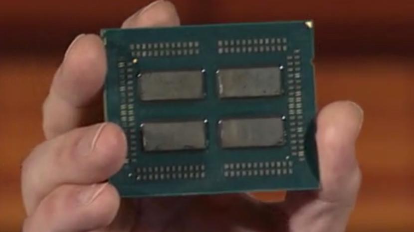

The latest image of the chip
And that center die looks only moderately larger than Zeppelin, just a bit wider... Look how small those core dies are.
Reactions: lightmanek
PeterScott
Jul 7, 2017
2,605
1,540
The biggest mystery is why the chiplets are paired off. Very strange.
May 11, 2008
20,261
1,151
Perhaps it is likely that there is some sort of crossbar between paired chiplets. To get 4 nodes of 16 cores. Perhaps how the 4 cores in a ccx are connected, the 4 ccx themselves are connected in the same way. To get a low latency connection between 16 cores. The chiplets perhaps share the L3 between them as one large L3. Not only using the two lowest bits , but now the three(8) or four(16) lowest bits.
4 of those 16cores / 4ccx nodes would make 64 core behemoth.
teejee
Jul 4, 2013
361
199
The pinout of SP3 is very likely adapted to EPYC 1 so my guess is they keep the same layout to better match the pinout for the SP3 socket and reduce the complexity of the module.
Especially the power pins should go directly into the silicon.
Tuna-Fish
Mar 4, 2011
1,475
1,977
My bet for the overall system architecture:
The cores in each chiplet are logically equidistant, that is, in one CCX. The L3 is 32MB and equally reachable from all cores, with lines hashed to the cache slices by the lowest bit of line addresses. It is not radically faster than Zen L3, and might actually be a bit slower. 30 cycles is already very fast for a 8MB cache, and while the shrinking transistors help speed, quadrupling size is going to hurt it.
There is a huge L4 that is memory side (that is, it only holds data from the memory channels connected to the die). It either is fully inclusive of all the data read from attached memory channels, or has enough extra tags so it at least holds tag entries for all cache lines held from those areas of ram. This allows it to manage all the coherency for multi-socket systems. The size of that L4 is probably 512MB, because the very first leak that mentioned 8+1 dies said that.
The fact that the chiplets are paired up is a red herring, for compatibility with existing cooling solutions or something. There is no data connection between those dies, except through the IO die.
