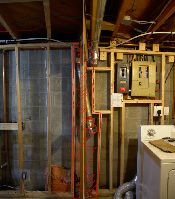

I'm insulating my basement, using spray foam for the areas that would be awkward to work with vapour barrier, and using roxul + plastic vapour barrier for the rest, and tying it all together as best as I can for maximum air tightness.
But what do I do for the dryer vent? I can't use plastic there as it will probably melt, and I probably should not use spray foam either? Is there some kind of foil based vapour barrier I can use?
Basically this is my setup, it's a really awkward way that pipe exits. (don't mind the other one that's just a bathroom vent, don't care too much about that one, it's the other one that exits behind the wall)
This is a view where I took out the partition wall just to make it easier to visualize:
The red is where the vapour barrier would go, the rest of the walls would then tie in with staples and tape.
So what would be the best product to use here that won't be affected by the heat of the dryer pipe? I know the Roxul batts will be fine, but still need some kind of air seal on the hot side.

Does your dryer melt the buttons on your shirt? Hehe, just put a thin layer of fiberglass in front of it, behind the poly if you're worried. Honestly, run your dryer as long as you want and put your hand on the duct.
But, just in case you don't know, DO NOT put screws into the duct for any reason. Clogging up the inside is a different matter and it will start a fire.

Who put the stupid wall there instead of six inches to the left?
If that's where your dryer goes, I'd think you could eliminate the solid duct almost completely. Is it necessary for code or some other reason?
Flexible ducting catches more lint than solid ducting and its use should be minimized. I run solid ducting for as long of a length as possible and then make the connection to the dryer using a short run of flex.
I doubt that three feet in his case is going to make any difference, and leaves him without a duct that ever has to be cleaned. The connection in my basement is at the ceiling, then there's a solid duct running about 15 feet to the outside wall, so requires about the same amount of flex duct as he'd need if he got rid of that piece in the wall.
* Edit *
Or... just bring the solid ducting outside the wall up above instead of trying to keep it inside the wall.
Yeah not sure why they put the wall right up against where the vent exits or why the exit is even that far down. The solid duct is there as that part is going to be hidden so I don't want flexible duct inside walls, but solid is overall better anyway. I may even put more solid going from the dryer straight up, so that way I can push the dryer in and have access to both ends and just put a short flex line.
Use a form to leave a cutout for where the exaust goes, make it an inch bigger than the exaust. Spray your insulation, remove form then use this to fill in the gap.

Touch-n-foam is what I'll be using (the system 400) but did not think of their fire retardant products, I think that may be an option for that section. Though I don't want to buy a whole setup just for that, so might just buy the cans then just do the part of the pipe that will touch vapour barrier, then do regular vapour barrier for rest. Since it's not a straight shoot out of the wall it makes it a bit more tricky.
Unless you think it needs to be hidden inside the wall, just bring out of the wall up above.

It is being brought out. It's the only way it can really go because that partition wall is in the way. Though now that I think about it, if I swap the exit points of both those vents it might make it easier, the other one is a bathroom fan, so I don't have to worry about what touches it. Then the other one is a straight shoot out so it will be easier to protect. I can do like sdifox said and use fire retardant foam around it.

But yeah think tomorrow what I'll do is swap those two pipes around. If I make the dryer exit at the hole that is not behind the wall it will allow me to do a straight shoot into the wall making it much easier to deal with. Then I can frame a square around it and vapour barrier all the way to the square, then use that fire retardant spray foam for inside the square to tie it all together as a continuous seal. The other pipe is just an exhaust fan so I don't have to worry about heat, can just tie normal plastic to it with tuck tape.

As for the dryer pipe, ended up not swapping it with the fan one it as it was too hard to remove the fan one as that one is screwed in and the framing stops from being able to get a screw driver in there (the pipe was added before). So I'll just ensure the long part of the dryer pipe in the pic has insulation in the spots where it might touch the wood or vapour barrier. For where it comes out I'll probably just do the fire rated foam. I can probably just tape the vapour barrier from the rest of the wall to the foam, put a shit load of acoustic seal and should be good I think.
