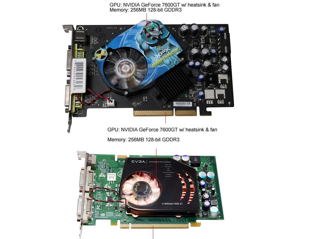

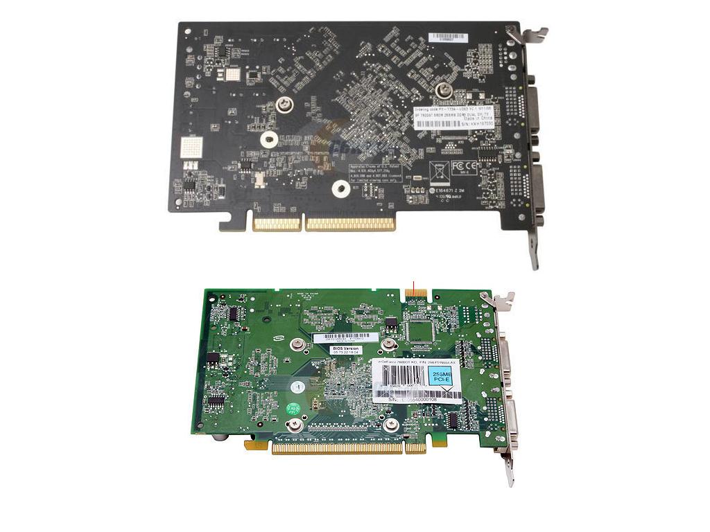

CHECK THIS OUT - I copy n' pasted a couple of pics...
I recently bought a 7600GT (top). I wanted something small with black PCB. It actually uses a 6600GT reference fan.
I assume your card looks something like the one on the bottom. This is obviously a totally different design!
Looking for an after-market cooler for a 7600GT is always problematic...
Happy hunting! :D

I used a Zalman VF-700 on an AGP 6600GT without a problem. The 6600GT and 7600GT have almost identical board designs.

Um..
Once again, it all depends on the design!
CHECK OUT THEIR BACKSIDES - in particular, the HSF screw locations...
7600GT coolers ar NOT one-size-fits-all! ;)
Try to actually look at that picture. The top card is an AGP model, which is physically the same as my 6600GT, which the VF-700 fits on. Do I really have to mount the cooler on the card and post a pic for you?
