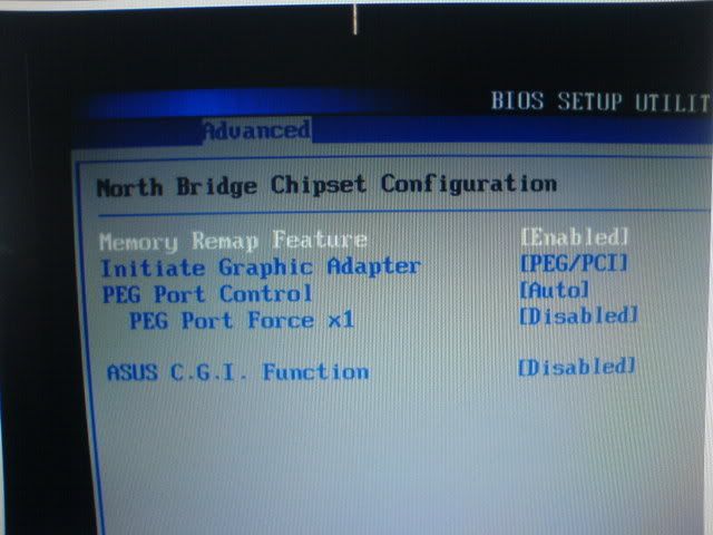

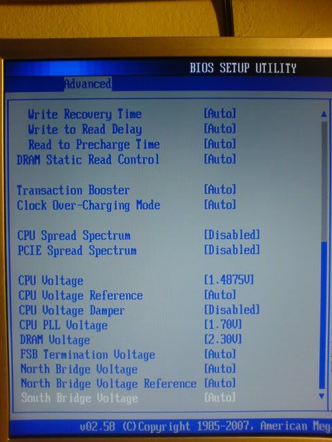

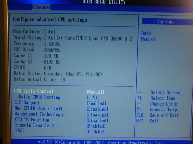

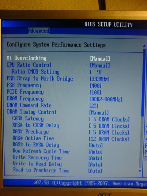

I'm having trouble getting my Q6600 G0 stable at 3.6GHz. I have an ASUS P5K Premium motherboard and an Ultra 120-Extreme heatsink with plenty of airflow in the case. I also have Patriot eXtreme Performance DDR2 800 (5-5-5-15) that I would like to keep at a 1:1 ratio. Please let me know what settings I should try changing. Thanks in advance.
http://i57.photobucket.com/alb...ioFreaK39/DSC02110.jpg
http://i57.photobucket.com/alb...ioFreaK39/DSC02109.jpg
http://i57.photobucket.com/alb...ioFreaK39/DSC02111.jpg
http://i57.photobucket.com/alb...ioFreaK39/DSC02112.jpg

Well turning on the Voltage Damper won't hurt.
It could be dying due to extreme heat? What are you temps according to CoreTemp BETA 95.4?
Try the above for starters.
you need to raise the FSB termination voltage past auto.
I would put it second to the highest possible, which is around 1.4-1.5
Quadcores communicate to each other though the FSB, so if your voltage is lacking you wont be stable.
Also you need to up your NB voltage as well. I would put it 2 above stock, and raise 1 until its stable.
Lastly, even G0's need at least 1.45Vcore in bios to load up at 3.6ghz. 1.45 in bios usually means around 1.41-1.42 after vdroop. So try to play with your voltages a little. I think thats where your wall is.

Thanks for the advice. I set the Vcore to 1.4875, the NB to 1.50 and the FSB termination a few steps above auto and now it's running stable after 6 hour of Prime95. Did not know that cores communicate to each other through the FSB. Learned something new, thanks.
