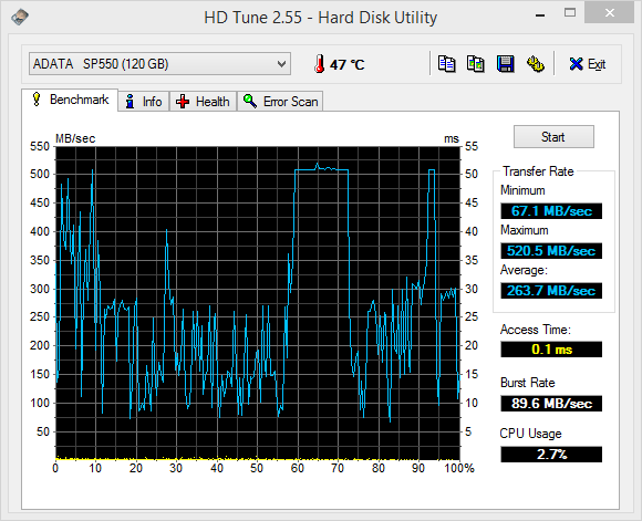

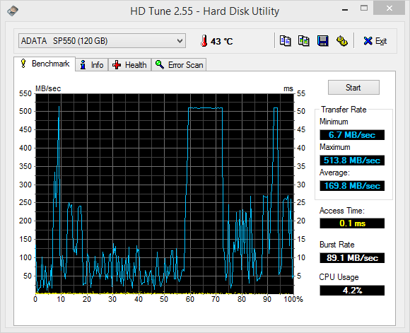

In the middle of December I decided it was time for another test.
This time I did transfer it to my desktop computer because I thought that enough time may have gone by for it to develop issues with read speeds.
Here you can see the results of a test with HD Tune:
As you can see they show a similar pattern as the 840/840 EVO, slightly lowered read speeds with some serious drops in performance along with a nice straight line which would be the empty space on the SSD.
This was after the ADATA SP550 had been left unpowered (by my estimation) a month to a month and a half.
The results show that the ADATA SP550 does have similar issues to the Samung 840/840 EVO have in regards to static data.

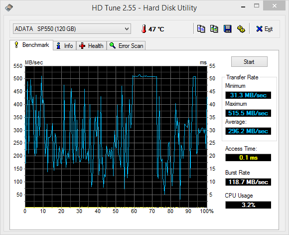

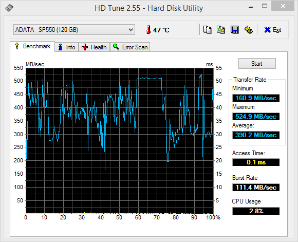

After I had left it unpowered for another month it was time for the next test, where I allowed it to remain powered on in the computer for about a day after the first test to see if speeds would improve.
Here you can see test results from HD Tune:
Read speeds do improve dramatically from the first to the second test, and do improve in general thereafter.
Keep in mind that I did perform a lot of reads, so it wasn't just fixing the read speeds while simply laying idle.

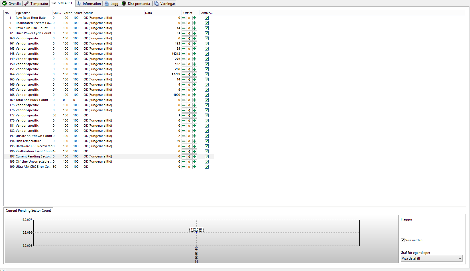

While running tests however I noticed something funny in Hard Disk Sentinel: Current Pending Sector Count had skyrocketed to 132,096 and then after a few minutes they disappeared despite no increase in reallocated sectors.
I'm guessing that would be the feature StaticDataRefresh at work, trying to fix those read speeds somehow, even if it did not appear to have rewritten any files on the drive.
Which you can see in this picture:
Admittedly, neither of these tests demonstrate that the ADATA SP550 would have issues with read speeds while in use where StaticDataRefresh can do it's job, something it cannot do when the drive is left unpowered.
