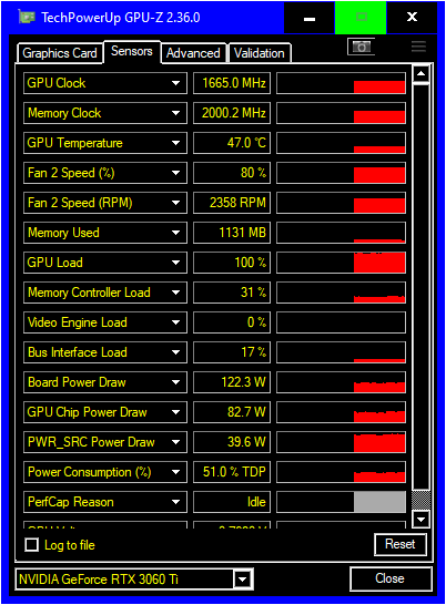

Having done some more testing with my 3090, I can confirm that that actual gpu chip doesn't actually draw that much power in stock settings, so it's not the 8nm node that's bad... it's actually totally eclipsed by the power drawn by the gddr6 and the circuit board , which can use up to 250w on their own. The PCIE slot supplys 60w and the 2x12v 8pins supply around 140w each and my 3090 absolutely maxes out at 350w. I do not raise the power limit, but I have reduced it, and the RAM continues to draw considerable power even when the gpu clocks are under 1ghz and down at 20W
How much does PWR_SRC power draw say? I assume that's the memory power.
If the board power and VRAM power was so bad (compared to other modern graphics cards), you would expect that the 3070 with GDDR6 (non-x) and a much simpler PCB and components would be much more efficient than a 3080 or 3090, but that doesn't seem to be the case?
