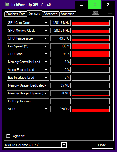

Do BOINC projects set the number of FLOP in a task correctly?
PrimeGrid PPS sieve (number sieve): estimated 49 238 FLOP
Hardware used: MSI GeForce GT 730 GK208, 1202 MHz (overclocked), 923 GFLOPS
Task appears to have almost no need for memory bandwidth, so I set memory frequency to the minimum.
Results: https://www.primegrid.com/results.php?hostid=529108&state=4&offset=0
Time to complete: 4600 s. However, I configured BOINC client to run two tasks simultaneously. See images, with "Resources" row saying "0.5 NVIDIA GPUs". Doing so will improve efficiency: two simultaneous tasks does not double their run times.
Effective time per task: 2300 s.
(49 238 GFLOP)/(2300 s) = 21.41 GFLOPS

tamz_msc
Jan 5, 2017
3,865
3,730
You seem to have a very high core overclock, my card starts causing game crashes if I exceed 1100 MHz. Is that task single or double precision?
