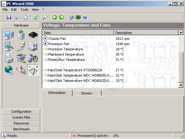

BTW, does the Tuniq Tower 120 work?!?! You be the judge...
Current Temps
