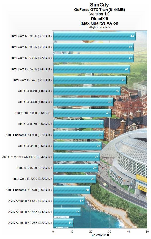

Depends what you have your 965 clocked at. In heavily multi-threaded tasks the FX's are much faster. In single threaded they are identical clock for clock (Talking pile driver).
Steam roller is supposed to be out this year, no clue if it will be AM3+ or not.

The most intense thing I do is the occasional game in triple screen mode something where you see the Intel 3770k and go I can get about a 20% Framerate increase and increase in all my apps as a second bonus but a second video card will almost double my framerate in a number of games.
Maybe Im just used to having a CPU this long that part of me thinks I need to upgrade despite not having a real good reason for doing so.
I started out on a mission then reality set in and I started to back out. I should just get the second video card its the cheapest fix.

You will see a small performance boost in single threaded apps and a large boost in multithreaded
But i would invest in a better GPU first like a GTX 660, HD 7870, or HD 7870 XT
