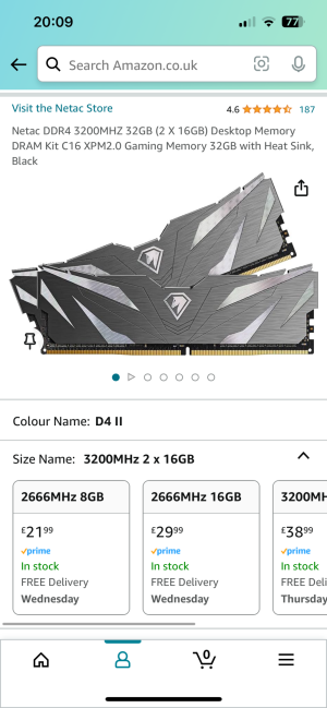

Netac Shadow Ram default 2666mhz xmp to 3200mhz as i have r5 4600g . 2x16gb sticks but im asking 1 because it was annoying to deal with last few days and 2 just for the sake of knowing if i wanna upgrade in the future to 4 sticks

Can you post a link to the exact kit of ram you bought? I've never heard of Netac ram before and i've seen almost every brand.

I believe this is the same one as mine I brought it off Amazon though .
