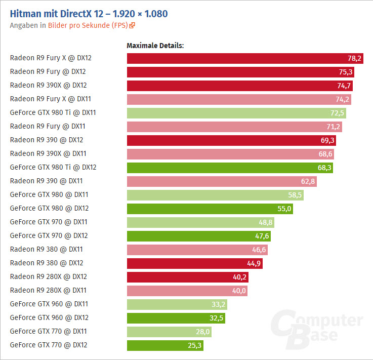

When I look at the benchmarks that have been done for this game, I am seeing a nice jump in performance based on video card. This usually means that, while a more powerful CPU will get you a couple more FPS, it won't be a huge jump.
you can see the difference between your 960 and a 980 (which should match your 1060) here:
In short, don't buy this CPU just to make this one game play better.
