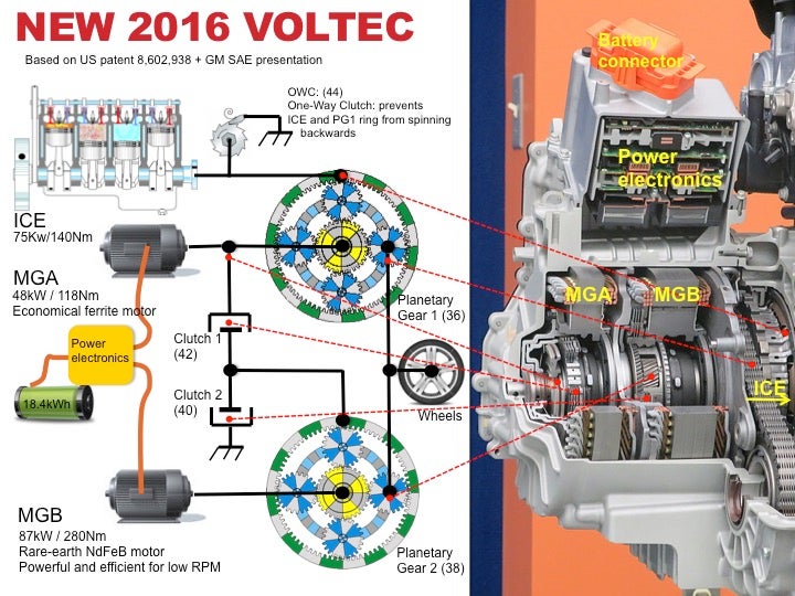

The Accord hybrid has 212hp peak output, with a 141hp gasoline motor and a 181hp electric motor.
But gasoline and electric adds up to 322 hp, where is missing 110 hp going?. Are the torque curves so off from each other or the drive train can't effectively combine them?
Yuriman
Jun 25, 2004
5,530
141
You can't add them like that.
It's a series hybrid, the electric motor is what drives the wheels. There is no engine torque curve to measure because there's no transmission, the engine just turns a generator that augments what the battery can deliver, except under a few circumstances where it's clutched to the wheels through a single-speed gearset (so very little drivetrain loss).
You'll notice the Volt can only produce 149hp to the wheels despite having a 101hp engine and 149hp of electric motors, AND having both electric and gas motors connected to the wheels together.
Accord:
Volt:
It's not commonly known that the Volt uses a transmission very much like the Prius's, and under some circumstances it behaves like a conventional ICE car.
Prius:

The most likely reason the Accord is more efficient is because its transmission design is simpler and has less losses vs the Volt's. The power split mechanism pioneered by Toyota was best in-class for over a decade but it's looking like some of the newer ideas are finally surpassing it.
It's kinda surprising it took this long though. The idea of using a clutch to more directly connect the wheels to the ICE has already been tried in various forms over the years (like VW's DCT connected hybrid) but never really matched up until relatively recently.
