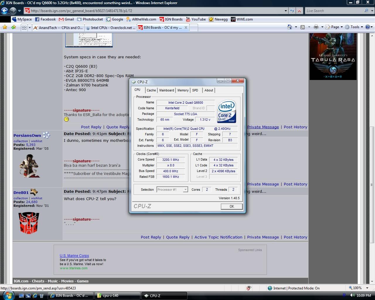

Secondly, when I open up CPU-Z, it says that there are only TWO cores. What's up with this? Here is a picture:
http://img.photobucket.com/alb...con23/CPU-ZReading.jpg

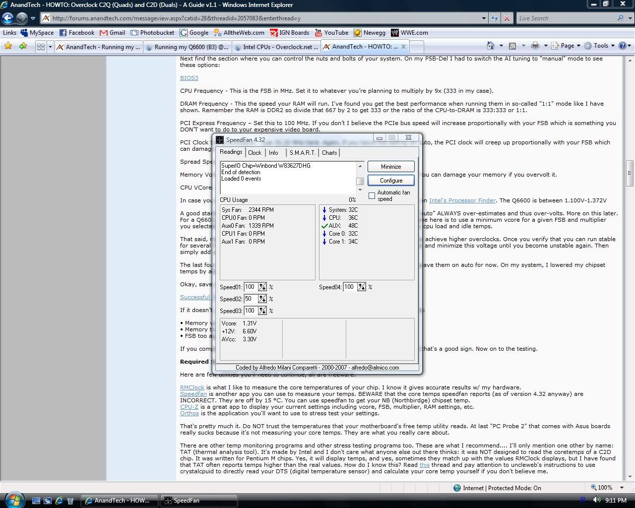

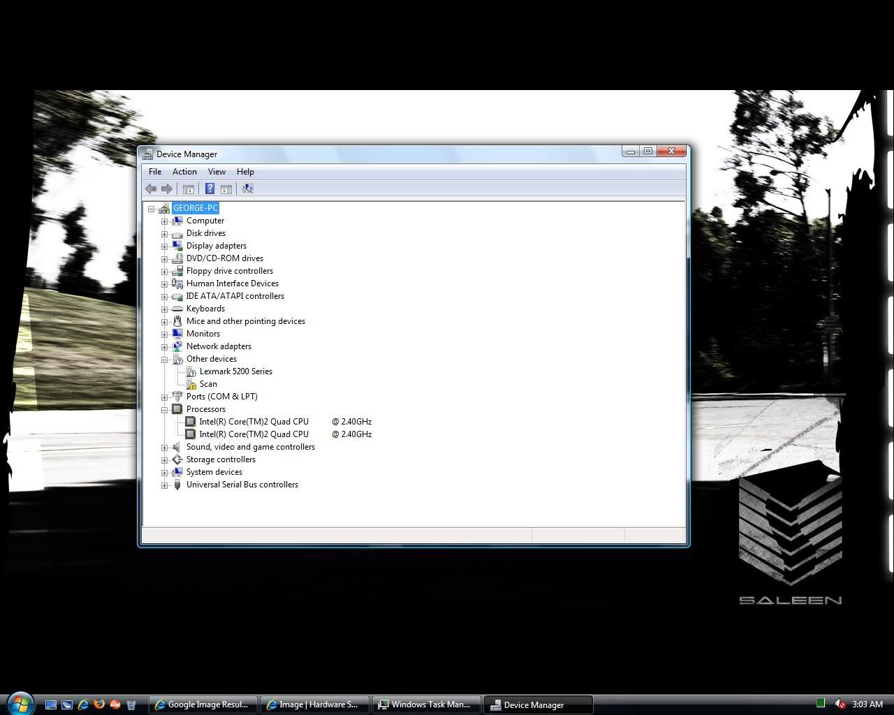

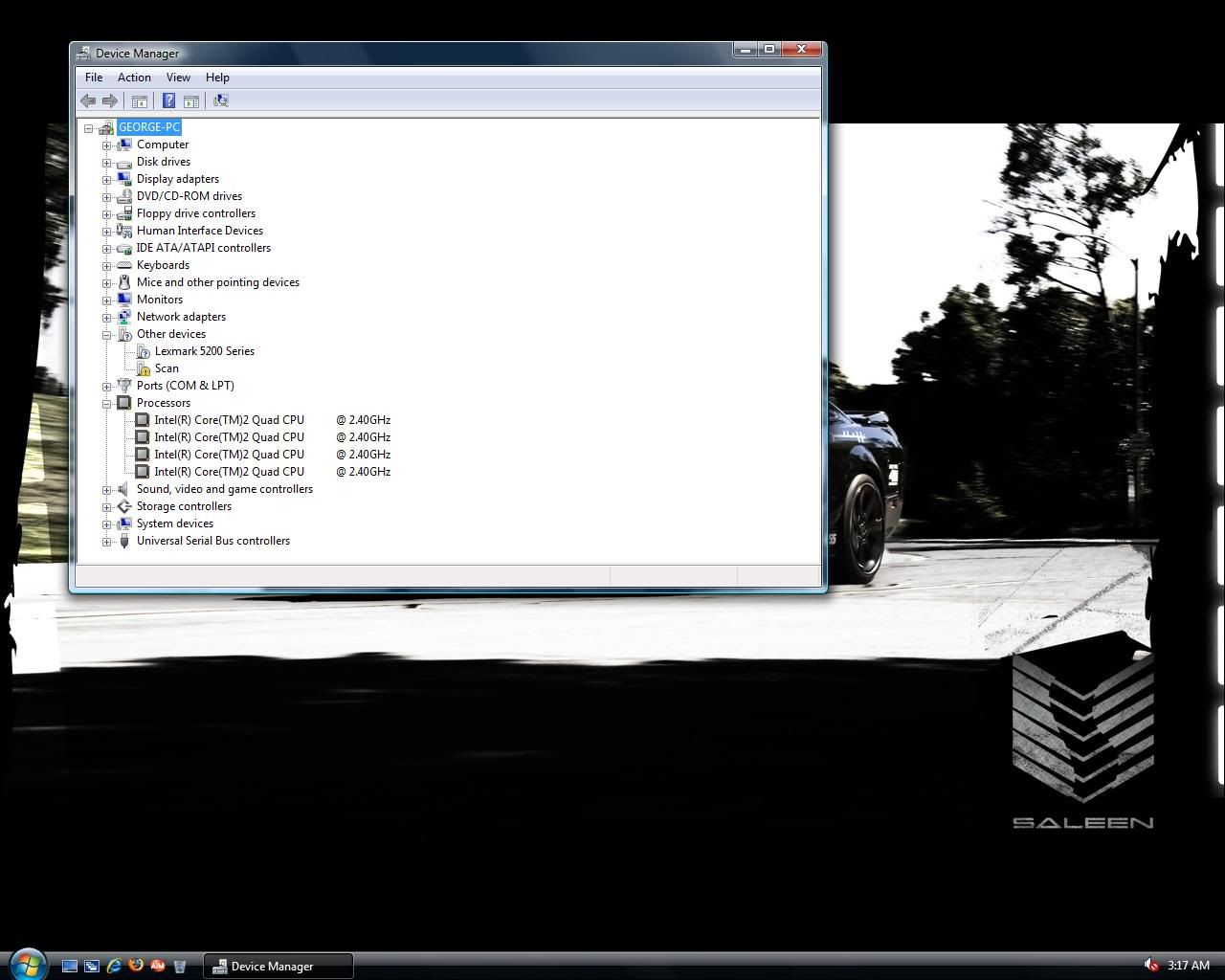

Finally, I am facing a similar problem in Speedfan. Sometimes it reads four cores, other times it will only read two cores. When it reads all four, the temps on each core are lower. When it only reads two cores, the temps on each are higher. What's up with this? How can I fix this? Here are some pics of the Speedfan problem:
When reading two cores:
http://img.photobucket.com/alb...nfalcon23/Speedfan.jpg
When reading four cores:
http://img.photobucket.com/alb...tainfalcon23/Temps.jpg

No it means your ram is running at its specced 800mhz, its ddr, dual data rate. It's all very confusing, wikipedia could help you out though.
As for the 2 core vs 4 core discrepancy, what does the windows taskmanger tell you? 2 or 4 cores ? I'm not very knowledgable about qauds coz I don't own one, nor have I built/oc-ed one for any friends of mine. Is it possible to disable cores to save energy? Not sure, if it is though, that might explain something. Also, what do cpu-z and speedfan tell you when you run your q6600 at stock speeds?
Oh, and your temps seem to be really low, unless you've got some AC blowing cold air right into your case I doubt your zalman 9700 could achieve those temps.

I just bumped it to 1.4xx. After my OC, my computer was triple booting. Now it's back to double booting (which is apparently normal for these P35 boards). Also, since my reboot last night, my system has been reading all four cores... I hope it stays this way.
