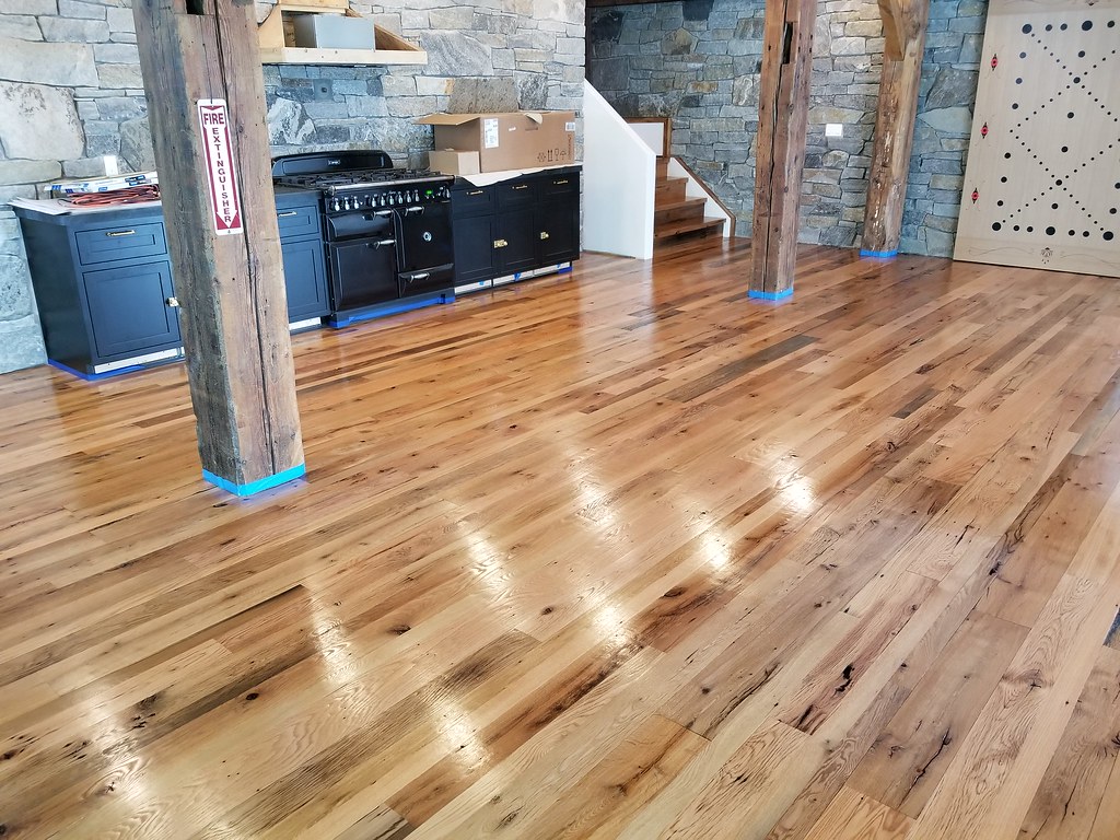

Just some pics of a couple recent installs I've done.
First up is 4000 sq ft of reclaimed oak from the erie canal. Used to be docks and stuff I guess.
20180303_082112 by bladerunnr40, on Flickr
20180303_082240 by bladerunnr40, on Flickr
20180301_085053 by bladerunnr40, on Flickr

Neither of those installs match my tastes, BUT I really want to compliment you on the quality of the installations, especially the reclaimed oak.
Very nicely done!

UnklSnappy
Apr 13, 2004
626
I agree with the grain on the quarter sawn, but wouldn't something like maple have been cheaper? At least the next owners can have the joy of sanding off the paint and finding it underneath :) What is the white topcoat? I hope it is something more durable than paint
The pics of the reclaimed oak were taken when the floors just had a couple coats of sealer on them. They were top coated with a coat of matte Glitsa.

Thank you, I truly enjoy my work when I'm on these jobs.

That reclaimed oak looks fantastic. Where does one get material like that?
You can get reclaimed wood from places like http://pioneermillworks.com/ and https://www.wideplankflooring.com/custom-floor/ both unfinished and pre-finished. But be prepared for the prices of $15+ per sq ft just for the material.

Love the first and third pics. The white oak...looks great but definitely not my taste. I would love to have the skills to refinish the butterscotch oak floors in my house to something darker.
